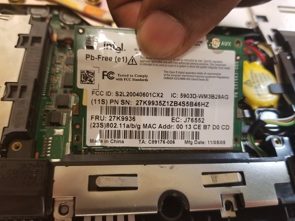

    5. IBM ThinkPad T43 WiFi Card Replacement: crwdns2935265:05crwdnd2935265:01crwdnd2935265:01crwdne2935265:0
      • The Wi-Fi Card is located towards the middle bottom of the laptop
    6. IBM ThinkPad T43 WiFi Card Replacement: crwdns2935265:06crwdnd2935265:01crwdnd2935265:02crwdne2935265:0 IBM ThinkPad T43 WiFi Card Replacement: crwdns2935265:06crwdnd2935265:02crwdnd2935265:02crwdne2935265:0
      • Locate the two wires connected at the top of the Wi-Fi card.
      • Hold the card down and use the tweezers to pinch the plug and pull up.
    7. IBM ThinkPad T43 WiFi Card Replacement: crwdns2935265:07crwdnd2935265:01crwdnd2935265:03crwdne2935265:0 IBM ThinkPad T43 WiFi Card Replacement: crwdns2935265:07crwdnd2935265:02crwdnd2935265:03crwdne2935265:0 IBM ThinkPad T43 WiFi Card Replacement: crwdns2935265:07crwdnd2935265:03crwdnd2935265:03crwdne2935265:0
      • Place fingers on the two clips holding the card in place
      • Pull the clips outwards until the the card pops up
      • Pull the card out by pulling out away from your body
      • To replace, follow these steps in reverse order
      • Make sure that the side with the short end is on the left when you put it back in.

I need to know what's role of the cables AUX and MAIN because i cut one
M a n i _001 - crwdns2934203:0crwdne2934203:0 crwdns2950251:0crwdne2950251:0
AUX and MAIN cables are antenna cables. In this laptop there are two antennas, MAIN and AUX.
If you have a soldering iron, simply solder the two parts of the cable you cut and everything is gonna be fine.
I also recommend using shrink tubing to isolate the soldered part.
Note : laptop can work without this câble, but WiFi speed and stability will suffer.
If you can't solder the câble or can't by a new one, you can try to use only main by pluggin the only remaining antena câble to MAIN and leaving AUX unlpuged.
