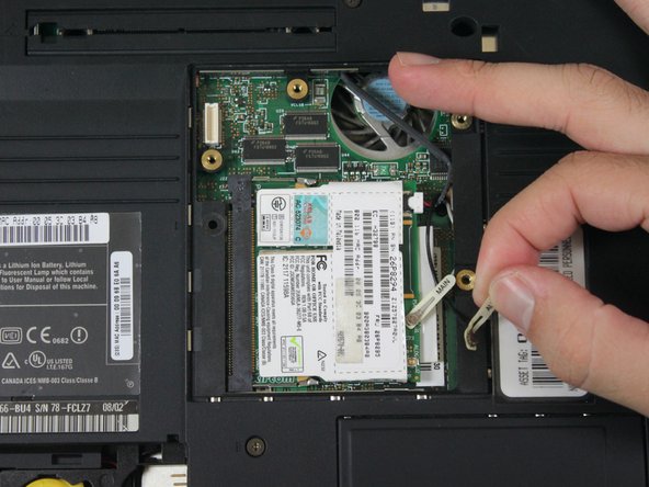

    • Before removing the wireless card, identify the three wires that need to be removed.
    • The first two wires that are on the bottom right can be easily unplugged with your fingers by pulling on the white label that comes with the wire.
    • For the last wire on the center right, use a plastic opening tool to pry out the wire.
  4. IBM ThinkPad T30 Wireless Card Replacement: crwdns2935265:04crwdnd2935265:01crwdnd2935265:03crwdne2935265:0 IBM ThinkPad T30 Wireless Card Replacement: crwdns2935265:04crwdnd2935265:02crwdnd2935265:03crwdne2935265:0 IBM ThinkPad T30 Wireless Card Replacement: crwdns2935265:04crwdnd2935265:03crwdnd2935265:03crwdne2935265:0
    • Use the plastic opening tool to pry the hinges on the side of the wireless card. These hinges hold the wireless card in place.
    • The wireless card will pop up at an angle, and can then be easily pulled out.
    • When reinserting a new wireless card, insert the card at the angle that it popped out. Then simply push the card down to lock it back into the hatch.
