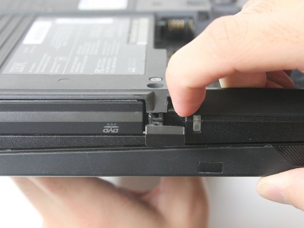

    2. IBM ThinkPad T30 Optical Drive Replacement: crwdns2935265:03crwdnd2935265:01crwdnd2935265:02crwdne2935265:0 IBM ThinkPad T30 Optical Drive Replacement: crwdns2935265:03crwdnd2935265:02crwdnd2935265:02crwdne2935265:0
      • On the side of the ThinkPad, locate a lock next to the optical drive. Use your fingernail to slide the lock to the right.
    3. IBM ThinkPad T30 Optical Drive Replacement: crwdns2935265:04crwdnd2935265:01crwdnd2935265:02crwdne2935265:0 IBM ThinkPad T30 Optical Drive Replacement: crwdns2935265:04crwdnd2935265:02crwdnd2935265:02crwdne2935265:0
      • Once it is unlocked, a small tab will pop out. Pull on the tab with your fingers.
      • The optical drive will easily slide out. Remove the optical drive.
