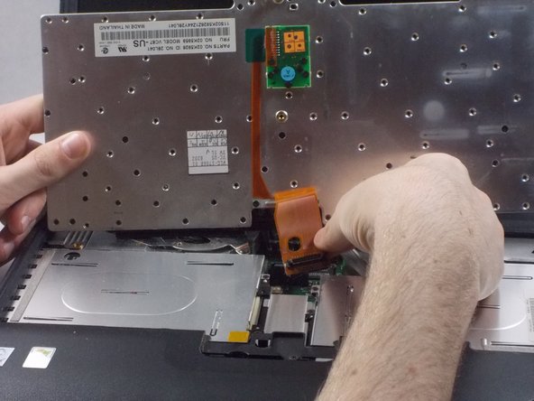

    • use a prying tool and insert it on the cracks on the sides of the keyboard and lift gently until you here a click
    • repeat this step on all sides of the keyboard until the keyboard is completely detached from the laptop
  4. IBM ThinkPad A31 Keyboard Replacement: crwdns2935265:04crwdnd2935265:01crwdnd2935265:03crwdne2935265:0 IBM ThinkPad A31 Keyboard Replacement: crwdns2935265:04crwdnd2935265:02crwdnd2935265:03crwdne2935265:0 IBM ThinkPad A31 Keyboard Replacement: crwdns2935265:04crwdnd2935265:03crwdnd2935265:03crwdne2935265:0
    • Lift the keyboard and remove the keyboard ribbon cable from the laptop
