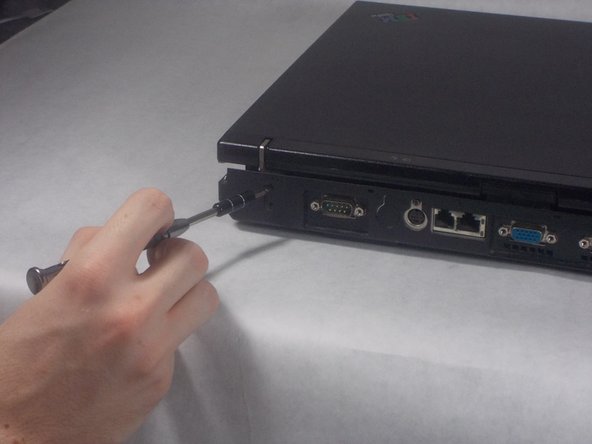

      • The sticker is to keep the warranty on the laptop so once removed the warranty is void
      • Peel the sticker and remove the 15mm screw
      • Remove all 6 of the 16mm screws

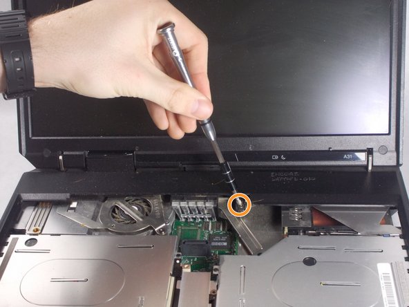

    1. IBM ThinkPad A31 Display Replacement, Display: crwdns2935265:04crwdnd2935265:01crwdnd2935265:02crwdne2935265:0 IBM ThinkPad A31 Display Replacement, Display: crwdns2935265:04crwdnd2935265:02crwdnd2935265:02crwdne2935265:0
      • Remove the one 21mm screw
      • Remove the 6mm screw

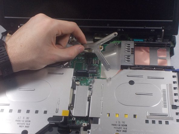

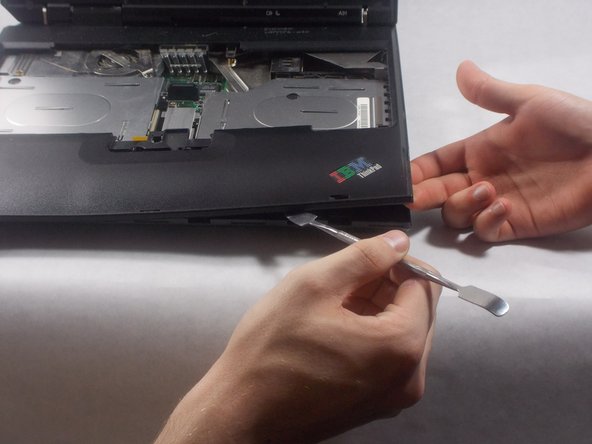

    2. IBM ThinkPad A31 Display Replacement: crwdns2935265:05crwdnd2935265:01crwdnd2935265:02crwdne2935265:0 IBM ThinkPad A31 Display Replacement: crwdns2935265:05crwdnd2935265:02crwdnd2935265:02crwdne2935265:0
      • Take the tool and run it under the black case.

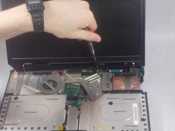

    3. IBM ThinkPad A31 Display Replacement: crwdns2935265:06crwdnd2935265:01crwdnd2935265:03crwdne2935265:0 IBM ThinkPad A31 Display Replacement: crwdns2935265:06crwdnd2935265:02crwdnd2935265:03crwdne2935265:0 IBM ThinkPad A31 Display Replacement: crwdns2935265:06crwdnd2935265:03crwdnd2935265:03crwdne2935265:0
      • Unscrew the 2 (17mm) screws
      • Unscrew the 6mm screw

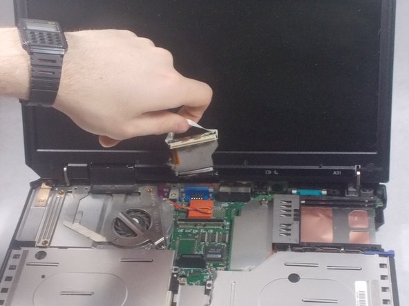

    4. IBM ThinkPad A31 Display Replacement: crwdns2935265:07crwdnd2935265:01crwdnd2935265:02crwdne2935265:0 IBM ThinkPad A31 Display Replacement: crwdns2935265:07crwdnd2935265:02crwdnd2935265:02crwdne2935265:0
      • Gently disconnect the white display ribbon cable
      • Pulling on the ribbon cable too hard could result in worse or faulty connection.

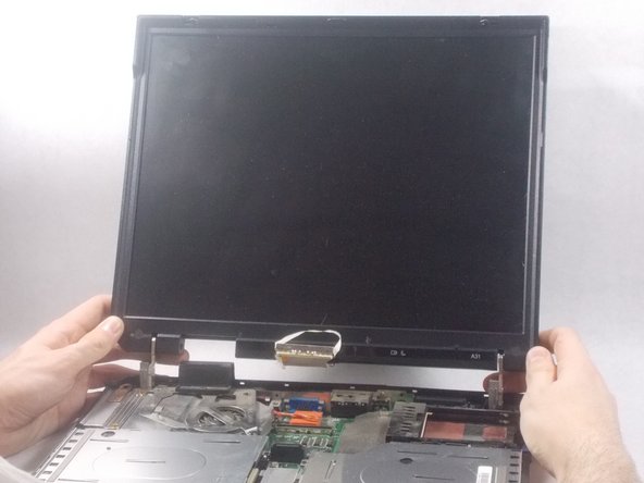

    5. IBM ThinkPad A31 Display Replacement: crwdns2935265:08crwdnd2935265:01crwdnd2935265:03crwdne2935265:0 IBM ThinkPad A31 Display Replacement: crwdns2935265:08crwdnd2935265:02crwdnd2935265:03crwdne2935265:0 IBM ThinkPad A31 Display Replacement: crwdns2935265:08crwdnd2935265:03crwdnd2935265:03crwdne2935265:0
      • Unscrew 4 (6mm) screws
      • Lift screen straight up
      • If not lifted straight up the screen could get damaged
