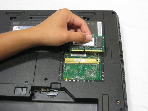

    2. IBM ThinkPad A30 RAM Replacement: crwdns2935265:03crwdnd2935265:01crwdnd2935265:01crwdne2935265:0
      • Remove RAM module by pressing the two metal pieces outward with your thumbs.
    3. IBM ThinkPad A30 RAM Replacement: crwdns2935265:04crwdnd2935265:01crwdnd2935265:02crwdne2935265:0 IBM ThinkPad A30 RAM Replacement: crwdns2935265:04crwdnd2935265:02crwdnd2935265:02crwdne2935265:0
      • Lift the RAM module up and out, away from the yellow connector.
      • Place the RAM module away from any magnets or static electricity prone areas.
