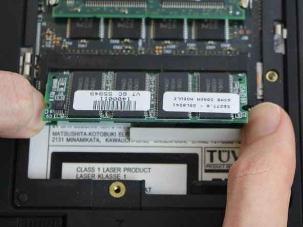

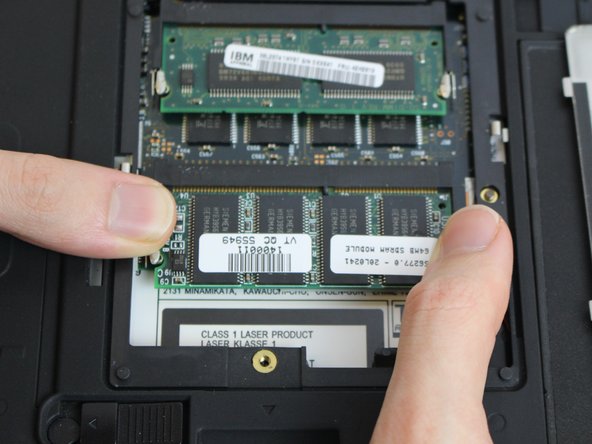

    • Using your fingers, pry the small retention clips apart until the ram pops up.

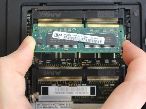

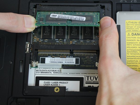

    • Using your fingers, pull straight in line with the ram to remove it.
  8. IBM ThinkPad 600E RAM Replacement: crwdns2935265:08crwdnd2935265:01crwdnd2935265:03crwdne2935265:0 IBM ThinkPad 600E RAM Replacement: crwdns2935265:08crwdnd2935265:02crwdnd2935265:03crwdne2935265:0 IBM ThinkPad 600E RAM Replacement: crwdns2935265:08crwdnd2935265:03crwdnd2935265:03crwdne2935265:0
    • Repeat steps 3 and 4 if you want to remove the second ram stick.
