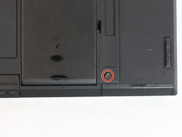

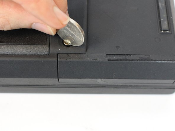

  5. IBM ThinkPad 600E Hard Drive Disk Replacement: crwdns2935265:05crwdnd2935265:01crwdnd2935265:03crwdne2935265:0 IBM ThinkPad 600E Hard Drive Disk Replacement: crwdns2935265:05crwdnd2935265:02crwdnd2935265:03crwdne2935265:0 IBM ThinkPad 600E Hard Drive Disk Replacement: crwdns2935265:05crwdnd2935265:03crwdnd2935265:03crwdne2935265:0
    • Using a coin, remove the coin screw by turning counterclockwise.
    • It's best to use a thicker coin, such as a nickel.

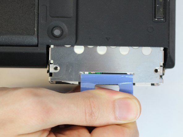

  7. IBM ThinkPad 600E Hard Drive Disk Replacement: crwdns2935265:07crwdnd2935265:01crwdnd2935265:03crwdne2935265:0 IBM ThinkPad 600E Hard Drive Disk Replacement: crwdns2935265:07crwdnd2935265:02crwdnd2935265:03crwdne2935265:0 IBM ThinkPad 600E Hard Drive Disk Replacement: crwdns2935265:07crwdnd2935265:03crwdnd2935265:03crwdne2935265:0
    • Utilizing your fingers, untuck the tab and pull to remove the hard drive.

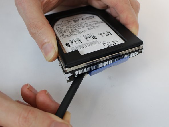

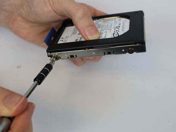

  8. IBM ThinkPad 600E Hard Drive Disk Replacement: crwdns2935265:08crwdnd2935265:01crwdnd2935265:03crwdne2935265:0 IBM ThinkPad 600E Hard Drive Disk Replacement: crwdns2935265:08crwdnd2935265:02crwdnd2935265:03crwdne2935265:0 IBM ThinkPad 600E Hard Drive Disk Replacement: crwdns2935265:08crwdnd2935265:03crwdnd2935265:03crwdne2935265:0
    • Using a screwdriver, remove the screws by turning them counterclockwise to remove the bracket.
    • four 3mm PH0 screws
    • The metal bracket is still attached with a weak adhesive tape, gently pry it off with a spudger.

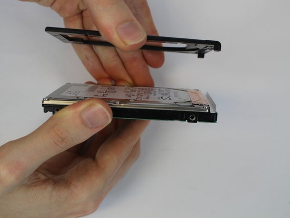

  9. IBM ThinkPad 600E Hard Drive Disk Replacement: crwdns2935265:09crwdnd2935265:01crwdnd2935265:02crwdne2935265:0 IBM ThinkPad 600E Hard Drive Disk Replacement: crwdns2935265:09crwdnd2935265:02crwdnd2935265:02crwdne2935265:0
    • The top plastic piece is adhered with a weak adhesive. Gently pry it off with a spudger.
