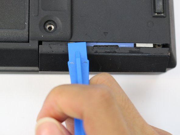

      • Flip the laptop over and find the battery latch.
    2. IBM ThinkPad 600E Display Replacement: crwdns2935265:02crwdnd2935265:01crwdnd2935265:01crwdne2935265:0
      • Move the latch to the side with the unlocked symbol.
    3. IBM ThinkPad 600E Display Replacement: crwdns2935265:03crwdnd2935265:01crwdnd2935265:03crwdne2935265:0 IBM ThinkPad 600E Display Replacement: crwdns2935265:03crwdnd2935265:02crwdnd2935265:03crwdne2935265:0 IBM ThinkPad 600E Display Replacement: crwdns2935265:03crwdnd2935265:03crwdnd2935265:03crwdne2935265:0
      • Pry the battery out using your fingers.

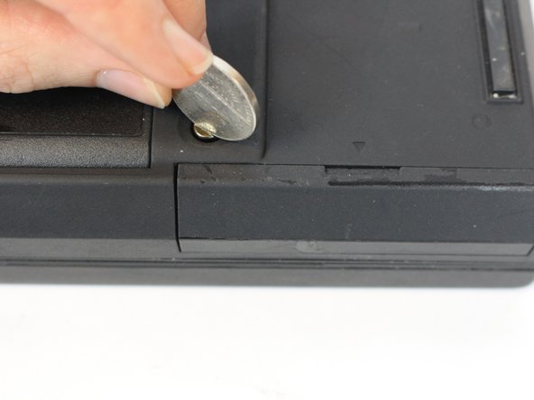

      • Unscrew the coin screw for the hard drive using a coin. Pry off the HDD cover.
      • It is easier to remove the coin screw using a thicker coin, such as a nickel.

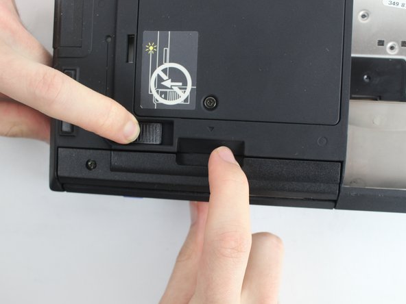

    2. IBM ThinkPad 600E Display Replacement: crwdns2935265:05crwdnd2935265:01crwdnd2935265:03crwdne2935265:0 IBM ThinkPad 600E Display Replacement: crwdns2935265:05crwdnd2935265:02crwdnd2935265:03crwdne2935265:0 IBM ThinkPad 600E Display Replacement: crwdns2935265:05crwdnd2935265:03crwdnd2935265:03crwdne2935265:0

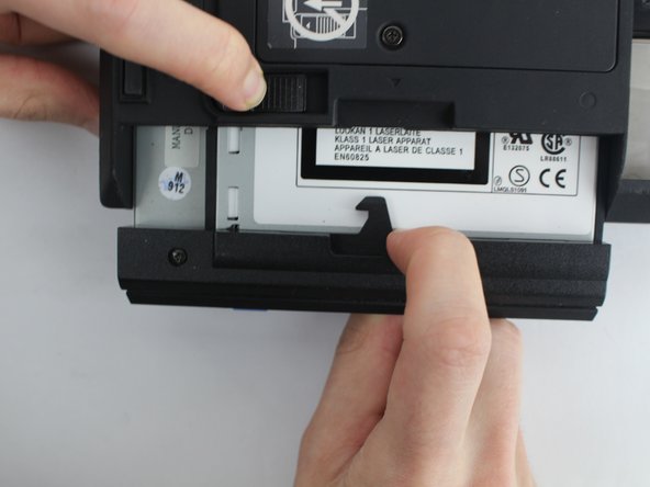

      • Unlock the highlighted latch and pull the disk drive out.
      • Remove the disk drive.

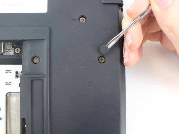

      • Most of the screws have a small, plastic covering attached with an adhesive. Use the metal spudger to pry it off. Make sure to note which screw came from which hole.
      • Four 18mm long M2.5 screws
      • Two 16mm long M2.5 screws
      • One 4.5mm long M2.5 screws
      • Four 3mm long M2.5 screws

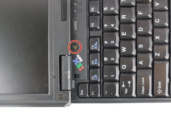

      • Open the laptop all the way until it is flat.
      • Take the black circle off and remove the screw.

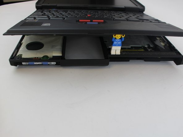

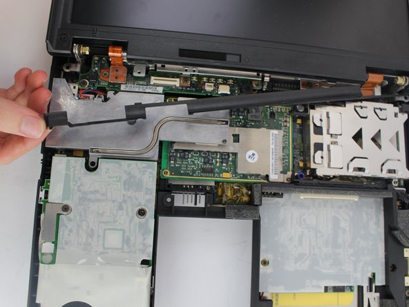

      • Pry the keyboard case up from the bottom and gently pry it up from all other edges.
      • Use caution when opening the case, as there are two ribbon cables attached to the keyboard case.

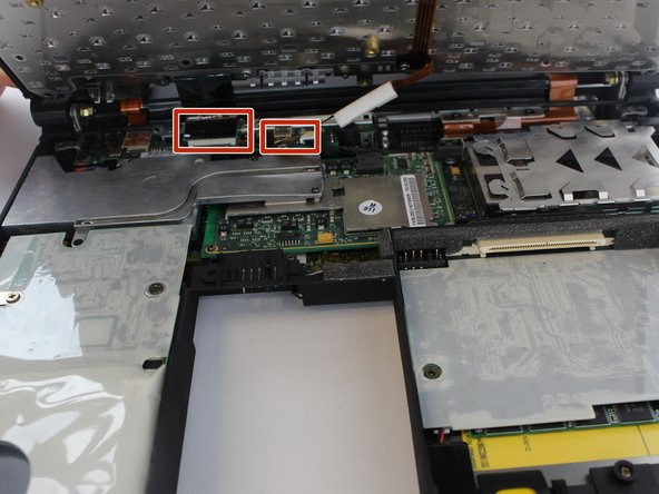

    6. IBM ThinkPad 600E Display Replacement: crwdns2935265:09crwdnd2935265:01crwdnd2935265:03crwdne2935265:0 IBM ThinkPad 600E Display Replacement: crwdns2935265:09crwdnd2935265:02crwdnd2935265:03crwdne2935265:0 IBM ThinkPad 600E Display Replacement: crwdns2935265:09crwdnd2935265:03crwdnd2935265:03crwdne2935265:0
      • Pry the connectors of the ribbon cables off slowly, lifting straight up. Wiggle gently side to side if necessary.

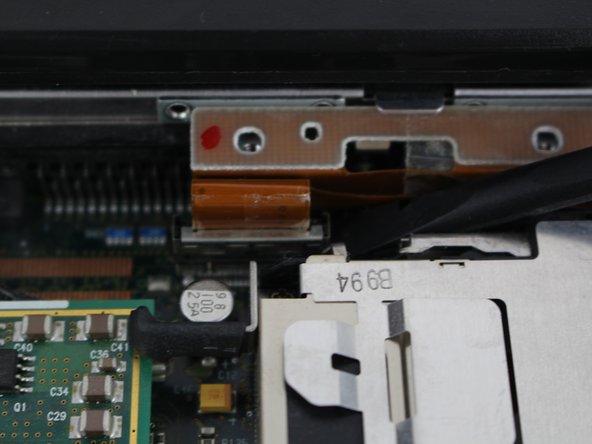

      • Remove the plastic part attached to the bottom of the screen.
      • Gently pull it from one side and then from another.

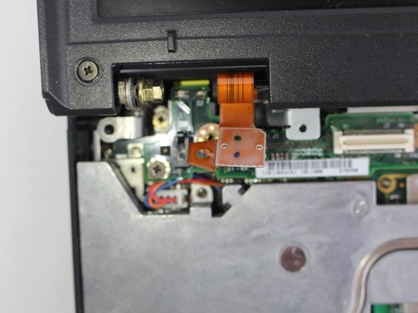

    2. IBM ThinkPad 600E Display Replacement: crwdns2935265:011crwdnd2935265:01crwdnd2935265:01crwdne2935265:0
      • Remove the highlighted screws.
      • Five 4.8mm long M2.5 screws

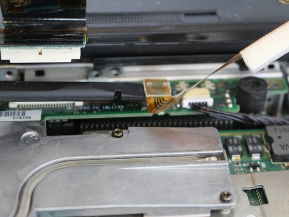

    3. IBM ThinkPad 600E Display Replacement: crwdns2935265:012crwdnd2935265:01crwdnd2935265:03crwdne2935265:0 IBM ThinkPad 600E Display Replacement: crwdns2935265:012crwdnd2935265:02crwdnd2935265:03crwdne2935265:0 IBM ThinkPad 600E Display Replacement: crwdns2935265:012crwdnd2935265:03crwdnd2935265:03crwdne2935265:0
