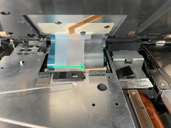

  3. IBM ThinkPad 380/385 Disassembly, Remove keyboard: crwdns2935265:03crwdnd2935265:01crwdnd2935265:03crwdne2935265:0 IBM ThinkPad 380/385 Disassembly, Remove keyboard: crwdns2935265:03crwdnd2935265:02crwdnd2935265:03crwdne2935265:0 IBM ThinkPad 380/385 Disassembly, Remove keyboard: crwdns2935265:03crwdnd2935265:03crwdnd2935265:03crwdne2935265:0
    • Before removing the keyboard, using a Plastic Spudger to slide the keyboard towards you and away from the screen assembly.
    • Once the keyboard is loosened, carefully lift it up from the front.
    • The keyboard is tethered by a safety clip to prevent damage to the ribbon cables.
    • Slide the safety clip to the side to release the keyboard.
    • Using a plastic spudger, gently release the bailers for all three (3) ribbon cables and slide them out.
    • You can now lift off the keyobard and set aside.
