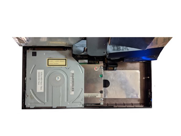

  4. IBM ThinkPad 365XD CD Drive Replacement, Removing CD Drive Screws/Cable: crwdns2935265:04crwdnd2935265:01crwdnd2935265:02crwdne2935265:0 IBM ThinkPad 365XD CD Drive Replacement, Removing CD Drive Screws/Cable: crwdns2935265:04crwdnd2935265:02crwdnd2935265:02crwdne2935265:0
    • Disconnect or remove the cable located above the drive, be careful as the cable is fragile.
    • You may use a flat head screwdriver or plier to remove the cable easier. Lightly push/lift up both sides of cable then pull it off.
    • Your drive should have 2 screws holding it down, remove them. They are small so keep track of them!
  5. IBM ThinkPad 365XD CD Drive Replacement, Removing  The CD-Drive: crwdns2935265:05crwdnd2935265:01crwdnd2935265:02crwdne2935265:0 IBM ThinkPad 365XD CD Drive Replacement, Removing  The CD-Drive: crwdns2935265:05crwdnd2935265:02crwdnd2935265:02crwdne2935265:0
    • Slide the drive down till it is out of the ThinkPad.
    • The ThinkPad uses a proprietary IDE connector, so not just any CD-Drive will work. Models that will work: Teac CD-44E, CD-46E, CD-48E.
