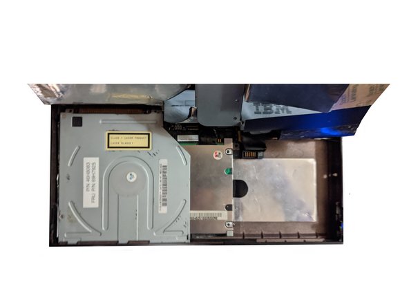

  3. IBM ThinkPad 365 X/XD Hard Drive Replacement, Removing Screws/Lifting Cover: crwdns2935265:03crwdnd2935265:01crwdnd2935265:02crwdne2935265:0 IBM ThinkPad 365 X/XD Hard Drive Replacement, Removing Screws/Lifting Cover: crwdns2935265:03crwdnd2935265:02crwdnd2935265:02crwdne2935265:0
    • Remove the following screws, there should be 3. Two of the screw spots may be slightly different on yours.
    • The cover has adhesive on it at these spots, pull it slowly till the adhesive releases. Then lift the cover up, you may need to hold it.
    • Keep track of the screws, the one that holds the drive to the board and cover is small, so don't loose it!

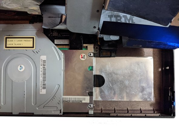

  4. IBM ThinkPad 365 X/XD Hard Drive Replacement, Removing the Hard Drive: crwdns2935265:04crwdnd2935265:01crwdnd2935265:03crwdne2935265:0 IBM ThinkPad 365 X/XD Hard Drive Replacement, Removing the Hard Drive: crwdns2935265:04crwdnd2935265:02crwdnd2935265:03crwdne2935265:0 IBM ThinkPad 365 X/XD Hard Drive Replacement, Removing the Hard Drive: crwdns2935265:04crwdnd2935265:03crwdnd2935265:03crwdne2935265:0
    • Using the top pull, pull the hard drive downwards till it detaches from the connector.
    • Alternately, if the drive will not pull out, you may push down on it from the right side next to the connector till it detaches.
    • Next, use the pull on the right side, pull it to the right lightly while lifting the drive.

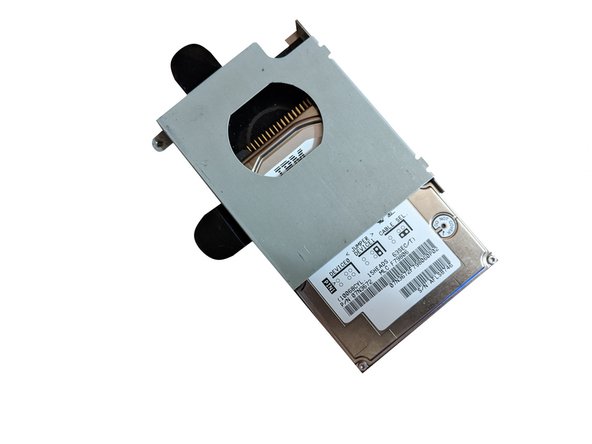

  5. IBM ThinkPad 365 X/XD Hard Drive Replacement, Replacing the Hard Drive: crwdns2935265:05crwdnd2935265:01crwdnd2935265:02crwdne2935265:0 IBM ThinkPad 365 X/XD Hard Drive Replacement, Replacing the Hard Drive: crwdns2935265:05crwdnd2935265:02crwdnd2935265:02crwdne2935265:0
    • Remove the 4 screws holding the hard drive in it's caddy. (2 each side)
    • Put the drive face up and slide it down out of the caddy.
    • If the hard drive will not slide out of the caddy, you may need to disassemble it. The caddy is made of two parts, face the caddy upside down with the top pull facing up and slide the reflective metal piece up, then pull it off.
    • Due to BIOS limitations, the ThinkPad only supports a drive size up to 8.4 GB, it will not notice the drive if it exceeds this limit.

What type of hdd is this please.
barry lawrence - crwdns2934203:0crwdne2934203:0
This is an IDE 2.5" HDD.
Beware : this laptop supports hdd up to 8,4 GB due to BIOS limitation, higher capacity hdds will not work.
