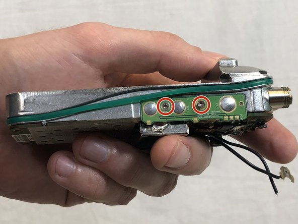

  8. Hytera TC-580 Speaker Replacement: crwdns2935265:08crwdnd2935265:01crwdnd2935265:02crwdne2935265:0 Hytera TC-580 Speaker Replacement: crwdns2935265:08crwdnd2935265:02crwdnd2935265:02crwdne2935265:0
    • Remove the two 15mm T8 Torx screws from the base of the battery cavity.

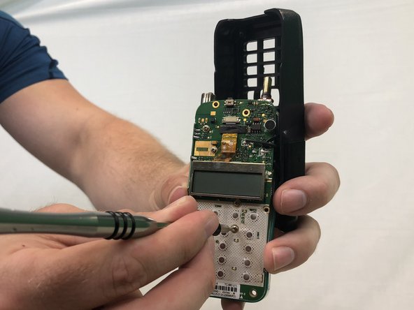

  11. Hytera TC-580 Speaker Replacement, Speaker: crwdns2935265:011crwdnd2935265:01crwdnd2935265:03crwdne2935265:0 Hytera TC-580 Speaker Replacement, Speaker: crwdns2935265:011crwdnd2935265:02crwdnd2935265:03crwdne2935265:0 Hytera TC-580 Speaker Replacement, Speaker: crwdns2935265:011crwdnd2935265:03crwdnd2935265:03crwdne2935265:0
    • Remove eleven 4mm Phillips #00 screws.
