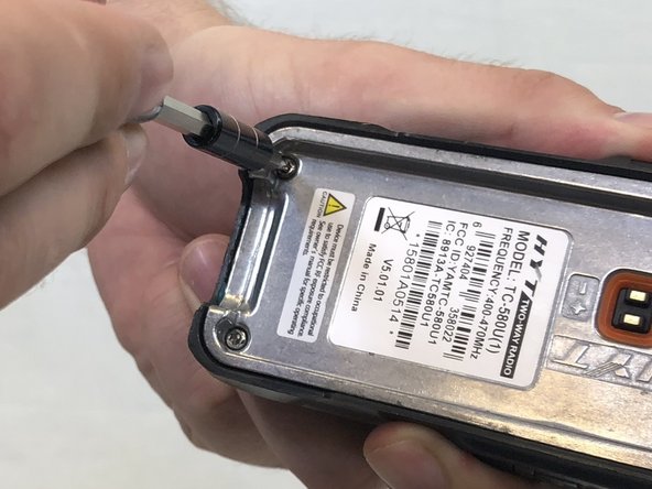

    • Remove the two 10mm Phillips #0 from the belt clip.
