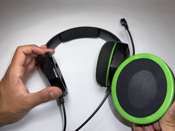

    • Starting with the right ear pad, place one finger on the outside of the ear pad and another finger on the inside.
    • Still gripping the ear pad, gently pull the ear pad away from the headset.
    • You will start to see the green flap leaving the groove of the headset.
    • Pull until the ear pad is fully detached.

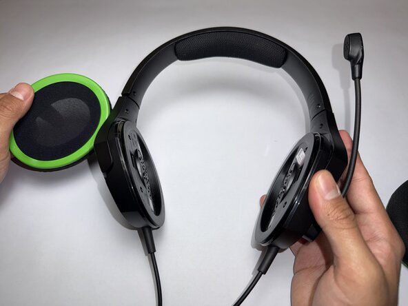

  2. HyperX CloudX Stinger Core 4P5J9AA Speakers Replacement: crwdns2935265:02crwdnd2935265:01crwdnd2935265:02crwdne2935265:0 HyperX CloudX Stinger Core 4P5J9AA Speakers Replacement: crwdns2935265:02crwdnd2935265:02crwdnd2935265:02crwdne2935265:0
    • Repeat Step 1 on the left side.
