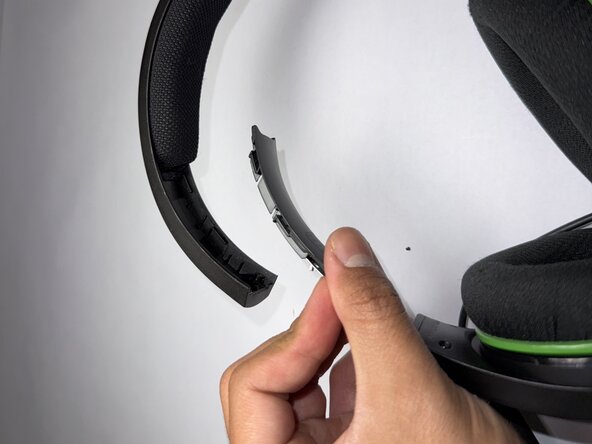

    • Remove the two pairs of 8 mm screws from each side of the headset using a Phillips #00 screwdriver.
  2. HyperX CloudX Stinger Core 4P5J9AA Headband Cushion Replacement: crwdns2935265:02crwdnd2935265:01crwdnd2935265:02crwdne2935265:0 HyperX CloudX Stinger Core 4P5J9AA Headband Cushion Replacement: crwdns2935265:02crwdnd2935265:02crwdnd2935265:02crwdne2935265:0
    • Extend the headset adjusters.
    • Push the black plastic piece on the inside of the headband away from the headband.
    • This will separate the headband from the rest of the parts and expose the cushion.
    • Repeat this on both sides of the headband.
  3. HyperX CloudX Stinger Core 4P5J9AA Headband Cushion Replacement: crwdns2935265:03crwdnd2935265:01crwdnd2935265:01crwdne2935265:0
    • When the headband is opened, the parts will be in this position. Make sure they remain in this position when it is reassembled.
    • A small metal piece may fall out.
    • Make sure the angle is facing the notched rail; it should be between the metal piece and the plastic piece.
  4. HyperX CloudX Stinger Core 4P5J9AA Headband Cushion Replacement: crwdns2935265:04crwdnd2935265:01crwdnd2935265:01crwdne2935265:0
    • Peel off the cushion and replace it with the new one.
