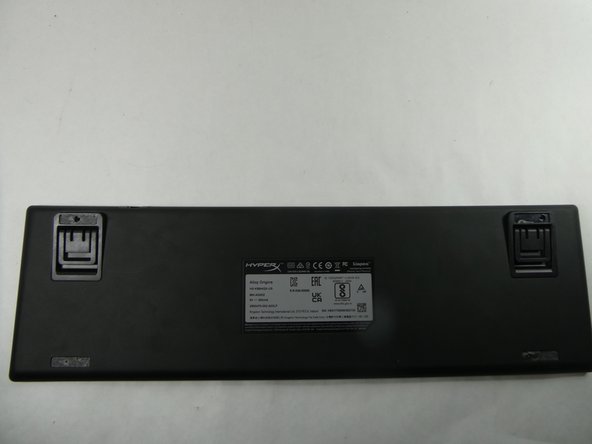

    • Locate the toggle indicator tab on the top right corner of the keyboard.

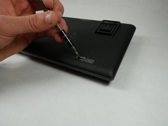

    • Flip the keyboard over so that the backplate is facing you.

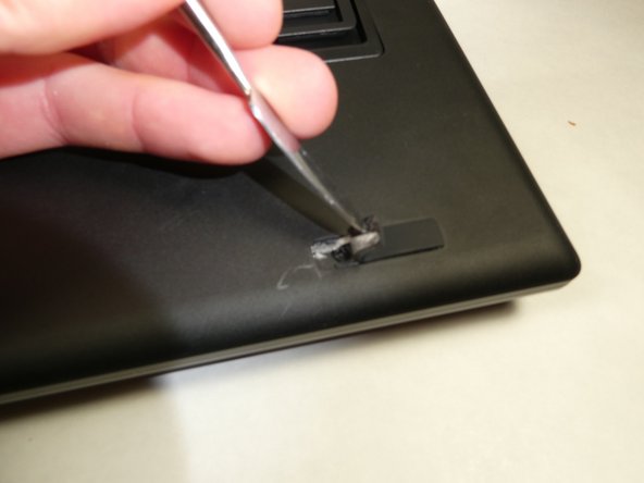

  4. HyperX Alloy Origins Key Switch Replacement: crwdns2935265:04crwdnd2935265:01crwdnd2935265:03crwdne2935265:0 HyperX Alloy Origins Key Switch Replacement: crwdns2935265:04crwdnd2935265:02crwdnd2935265:03crwdne2935265:0 HyperX Alloy Origins Key Switch Replacement: crwdns2935265:04crwdnd2935265:03crwdnd2935265:03crwdne2935265:0
    • Remove the rubber feet on the four corners of the backplate.
    • When reassembling, use an adhesive to reattach the feet. A silicone rubber adhesive is recommended.

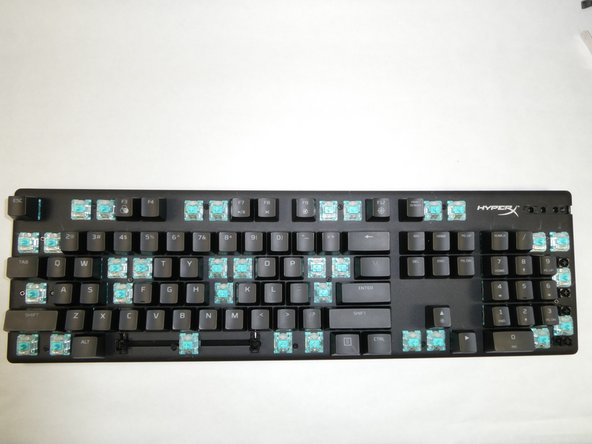

  5. HyperX Alloy Origins Key Switch Replacement: crwdns2935265:05crwdnd2935265:01crwdnd2935265:03crwdne2935265:0 HyperX Alloy Origins Key Switch Replacement: crwdns2935265:05crwdnd2935265:02crwdnd2935265:03crwdne2935265:0 HyperX Alloy Origins Key Switch Replacement: crwdns2935265:05crwdnd2935265:03crwdnd2935265:03crwdne2935265:0

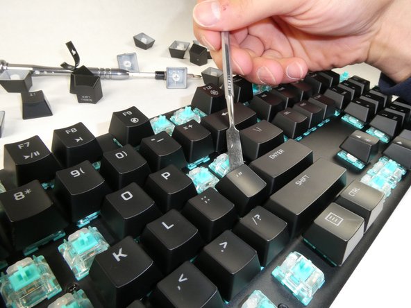

    • Remove the specified keycaps as depicted in the image.
  6. HyperX Alloy Origins Key Switch Replacement: crwdns2935265:06crwdnd2935265:01crwdnd2935265:03crwdne2935265:0 HyperX Alloy Origins Key Switch Replacement: crwdns2935265:06crwdnd2935265:02crwdnd2935265:03crwdne2935265:0 HyperX Alloy Origins Key Switch Replacement: crwdns2935265:06crwdnd2935265:03crwdnd2935265:03crwdne2935265:0

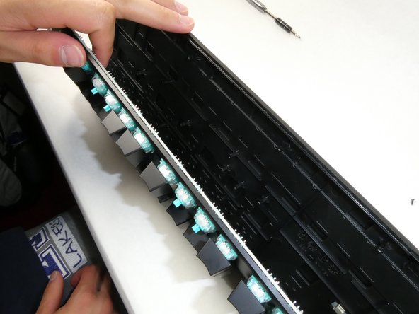

    • Remove all Philips #0 screws from the new openings created after removing the rubber feet and plastic tab.
  7. HyperX Alloy Origins Key Switch Replacement: crwdns2935265:07crwdnd2935265:01crwdnd2935265:03crwdne2935265:0 HyperX Alloy Origins Key Switch Replacement: crwdns2935265:07crwdnd2935265:02crwdnd2935265:03crwdne2935265:0 HyperX Alloy Origins Key Switch Replacement: crwdns2935265:07crwdnd2935265:03crwdnd2935265:03crwdne2935265:0
    • Separate the backplate from the keyboard using your hands.

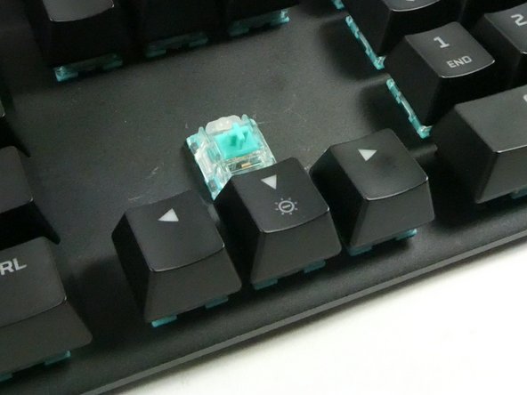

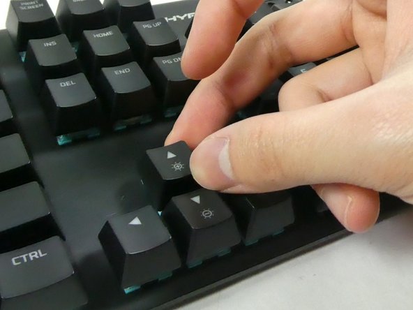

  8. HyperX Alloy Origins Key Switch Replacement, Key Switch: crwdns2935265:08crwdnd2935265:01crwdnd2935265:03crwdne2935265:0 HyperX Alloy Origins Key Switch Replacement, Key Switch: crwdns2935265:08crwdnd2935265:02crwdnd2935265:03crwdne2935265:0 HyperX Alloy Origins Key Switch Replacement, Key Switch: crwdns2935265:08crwdnd2935265:03crwdnd2935265:03crwdne2935265:0
    • Identify the key switch to be replaced.
    • Remove its keycap by carefully prying it off of the keyboard with your fingers.

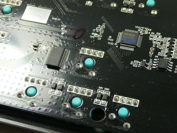

    • Flip the keyboard over to face the PCB.
    • Identify the corresponding switch to be removed.
  10. HyperX Alloy Origins Key Switch Replacement: crwdns2935265:010crwdnd2935265:01crwdnd2935265:01crwdne2935265:0

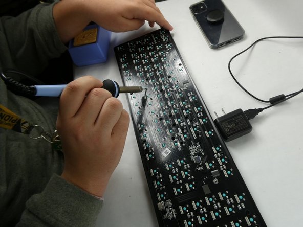

    • Plug in and turn on your soldering iron.
    • Do not touch the metal end of the soldering iron while it is powered on. Allow the soldering iron to cool before stowing it away.

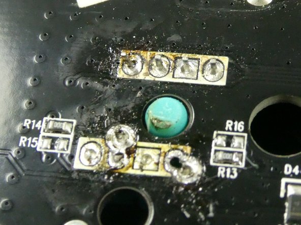

    Desoldering Pump
    $3.99
    • Melt the solder surrounding the four pins of the switch's LED, and the two lower pins of the switch body.
    • To remove the melted solder, use a desoldering iron, a desoldering pump, or desoldering braid.
    • The exposed switch pins are susceptible to damage from the soldering iron. Avoid applying heavy pressure to mitigate pin bending.
  12. HyperX Alloy Origins Key Switch Replacement: crwdns2935265:012crwdnd2935265:01crwdnd2935265:01crwdne2935265:0
    • Using a spudger or another metallic instrument, firmly press down upon the exposed plastic of the switch. This will separate the switch from the rest of the keyboard.
    • If the switch's pins will not separate from the keyboard's PCB, continue applying the soldering iron to the pins to melt any residual solder.
