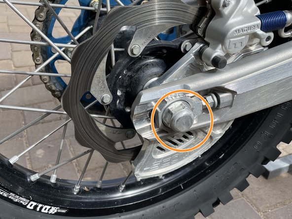

    • Place the motorcycle on a stand so that the rear tire is off the ground.
  2. Husqvarna FE 350 Rear Sprocket Replacement: crwdns2935265:02crwdnd2935265:01crwdnd2935265:02crwdne2935265:0 Husqvarna FE 350 Rear Sprocket Replacement: crwdns2935265:02crwdnd2935265:02crwdnd2935265:02crwdne2935265:0
    • Use the 27mm wrench to unscrew the nut that holds the axle together. This nut is located on the right side of the motorcycle at the end of the swing-arm.

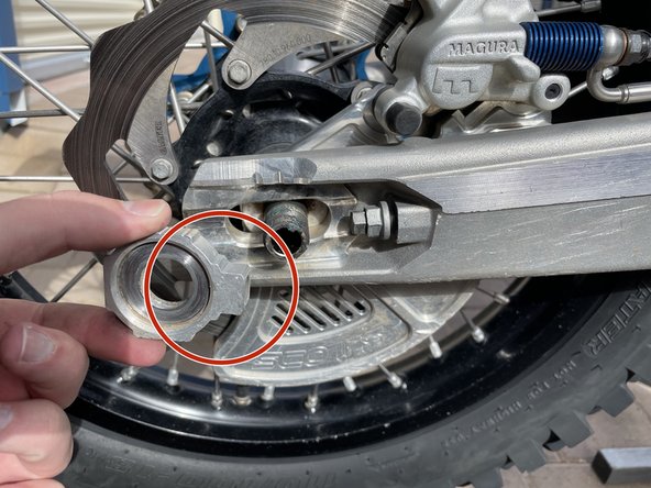

    • Move to the left side of the motorcycle and remove the axle by pulling it directly out.

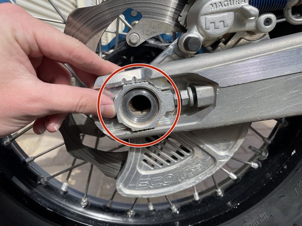

    • Move back to the right side and remove the spacer shown in the third picture to ensure that is does not get lost.
