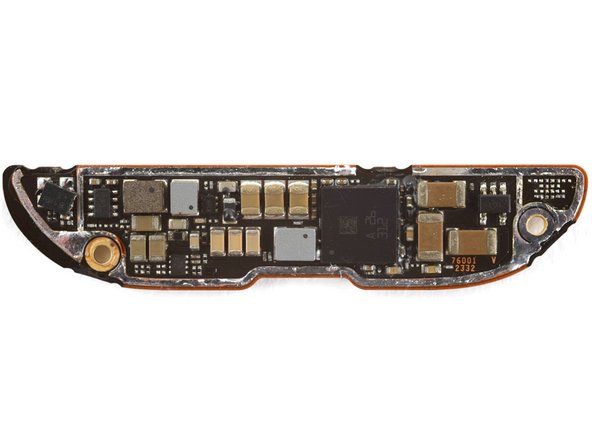

    1. Humane AI Pin Chip ID, Main Board Side 1: crwdns2935265:01crwdnd2935265:01crwdnd2935265:02crwdne2935265:0 Humane AI Pin Chip ID, Main Board Side 1: crwdns2935265:01crwdnd2935265:02crwdnd2935265:02crwdne2935265:0
      • Qualcomm SM7125-100-AB Snapdragon 720G octa-core applications & baseband processor
      • Kingston 32EM32-M4DTX29 32 GB NAND flash & 4 GB LPDDR4X SDRAM memory
      • STMicroelectronics ST33K secure microcontroller
      • Infineon CY8C4045FNI-S412T 32-bit PSoC 4000S microcontroller
      • STMicroelectronics STWLC86 wireless power reciever
      • Qualcomm WSA8810-0VV audio amplifier
      • STMicroelectronics LED1202 12-ch. LED driver

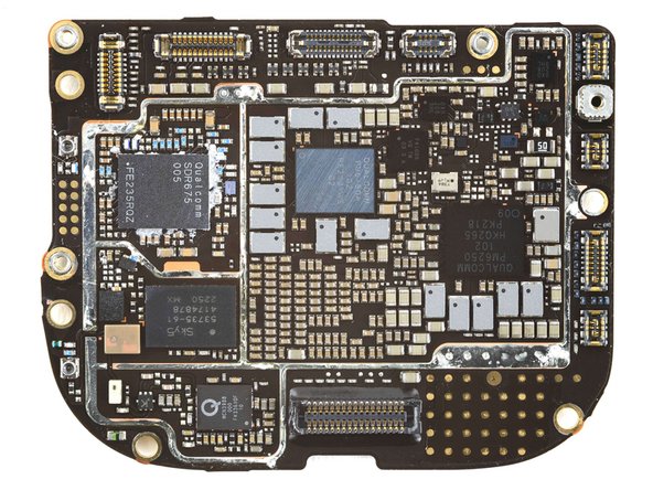

    5. Humane AI Pin Chip ID, Main Board Side 2: crwdns2935265:05crwdnd2935265:01crwdnd2935265:02crwdne2935265:0 Humane AI Pin Chip ID, Main Board Side 2: crwdns2935265:05crwdnd2935265:02crwdnd2935265:02crwdne2935265:0
      • STMicroelectronics STM32F410TB 32-bit ARM Cortex-M4 microcontroller
      • Qualcomm PM6250-102 power management
      • Qualcomm PM6150A-102 power management
      • Texas Instruments BQ25175 battery charger
    6. Humane AI Pin Chip ID, Main Board Side 2 - Connectivity: crwdns2935265:06crwdnd2935265:01crwdnd2935265:01crwdne2935265:0
      • Qualcomm WCN3988-000 WLAN 1x1 802.11a/b/g/n/ac, Bluetooth 5.0, & FM controller
      • Qualcomm SDR675-005 RF transceiver
      • Skyworks SKY53735-61 diversity receive module
      • Skyworks SKY13351-378LF GaAs SPDT RF switch

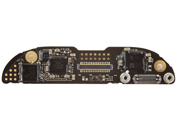

    7. Humane AI Pin Chip ID, Laser Projector Board Side 1: crwdns2935265:07crwdnd2935265:01crwdnd2935265:02crwdne2935265:0 Humane AI Pin Chip ID, Laser Projector Board Side 1: crwdns2935265:07crwdnd2935265:02crwdnd2935265:02crwdne2935265:0
      • STMicroelectronics MEMS motor driver
      • Monolithic Power Systems MP3438GTL synchronous boost converter
      • Texas Instruments INA280A1QDCKRQ1 current sense amplifier
    8. Humane AI Pin Chip ID, Laser Projector Board Side 2: crwdns2935265:08crwdnd2935265:01crwdnd2935265:02crwdne2935265:0 Humane AI Pin Chip ID, Laser Projector Board Side 2: crwdns2935265:08crwdnd2935265:02crwdnd2935265:02crwdne2935265:0
      • Lattice Semiconductor LIFCL-17-8UWG72C CrossLink-NX FPGA
      • STMicroelectronics STM32F412RG 32-bit ARM Cortex-M4 microcontroller
      • STMicroelectronics STLDDx laser diode driver
