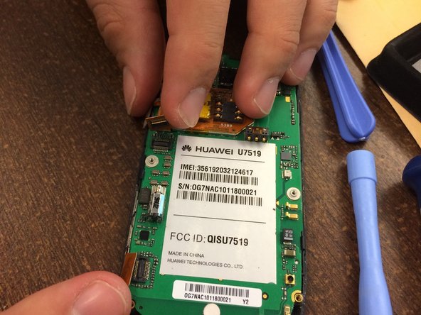

  5. Huawei u7519 Screen Replacement: crwdns2935265:05crwdnd2935265:01crwdnd2935265:01crwdne2935265:0
    • Carefully pull the backing of the phone from the motherboard with your hands.

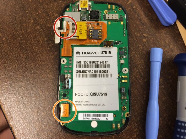

  6. Huawei u7519 Screen Replacement, Screen: crwdns2935265:06crwdnd2935265:01crwdnd2935265:02crwdne2935265:0 Huawei u7519 Screen Replacement, Screen: crwdns2935265:06crwdnd2935265:02crwdnd2935265:02crwdne2935265:0
    • To remove front case from the motherboard, first pull back the silver tab (highlighted in blue) and the orange tab (highlighted in red).
  7. Huawei u7519 Screen Replacement: crwdns2935265:07crwdnd2935265:01crwdnd2935265:02crwdne2935265:0 Huawei u7519 Screen Replacement: crwdns2935265:07crwdnd2935265:02crwdnd2935265:02crwdne2935265:0
    • Once the silver and orange tabs are pulled back, carefully pull the motherboard apart from the front case.

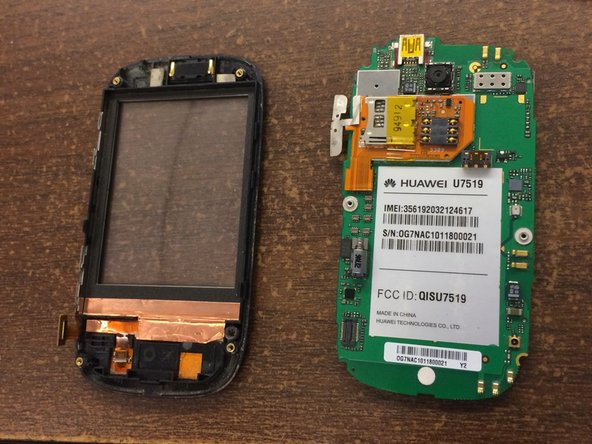

  8. Huawei u7519 Screen Replacement: crwdns2935265:08crwdnd2935265:01crwdnd2935265:01crwdne2935265:0
    • Now that the motherboard is separate from the front case, you can discard the original motherboard.
    • The LCD screen can not be removed from the motherboard. Therefore, a new motherboard must be purchased in order to replace this screen.
