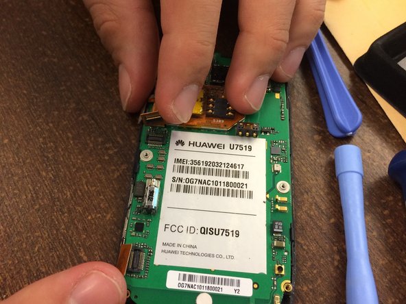

  5. Huawei u7519 Camera Replacement: crwdns2935265:05crwdnd2935265:01crwdnd2935265:01crwdne2935265:0
    • Carefully pull the backing of the phone from the motherboard with your hands.
  6. Huawei u7519 Camera Replacement, Camera: crwdns2935265:06crwdnd2935265:01crwdnd2935265:02crwdne2935265:0 Huawei u7519 Camera Replacement, Camera: crwdns2935265:06crwdnd2935265:02crwdnd2935265:02crwdne2935265:0

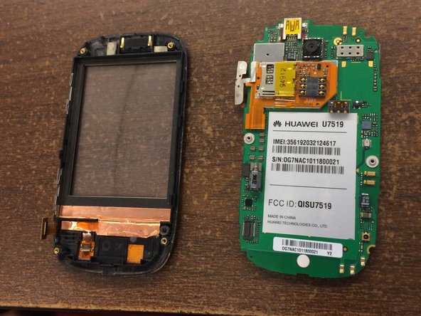

    • To remove front encasing from the motherboard, first pull back the orange tabs.
  7. Huawei u7519 Camera Replacement: crwdns2935265:07crwdnd2935265:01crwdnd2935265:02crwdne2935265:0 Huawei u7519 Camera Replacement: crwdns2935265:07crwdnd2935265:02crwdnd2935265:02crwdne2935265:0
    • Once the orange tabs are pulled back, carefully pull the motherboard apart from the front casing.
  8. Huawei u7519 Camera Replacement: crwdns2935265:08crwdnd2935265:01crwdnd2935265:01crwdne2935265:0
    • The camera is not removable from the motherboard. Therefore, a new motherboard must be purchased in order to replace the camera.
