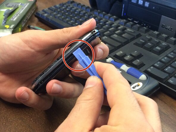

  4. Huawei u7519 Back Cover Replacement: crwdns2935265:04crwdnd2935265:01crwdnd2935265:01crwdne2935265:0
    • Once all the screws are removed, use the iPod opening tool to pry off the back covering of the phone along the edge of the back cover and you will have access to the motherboard.
    • The power and volume buttons will fall out of the phone. Set aside for reassembly.

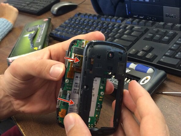

  5. Huawei u7519 Back Cover Replacement: crwdns2935265:05crwdnd2935265:01crwdnd2935265:01crwdne2935265:0
    • Carefully pull the backing of the phone from the motherboard with your hands.
