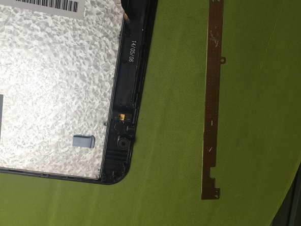

  4. Huawei mediapad t1 7.0" Touchscreen  Replacement: crwdns2935265:04crwdnd2935265:01crwdnd2935265:03crwdne2935265:0 Huawei mediapad t1 7.0" Touchscreen  Replacement: crwdns2935265:04crwdnd2935265:02crwdnd2935265:03crwdne2935265:0 Huawei mediapad t1 7.0" Touchscreen  Replacement: crwdns2935265:04crwdnd2935265:03crwdnd2935265:03crwdne2935265:0
    • Rimuovere le 6 viti che tengono bloccato il display con le 2 strisce dì metallo
    • Rimuovere display

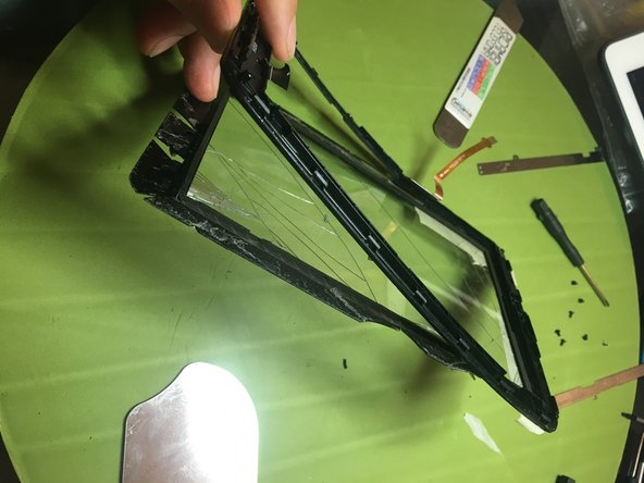

  5. Huawei mediapad t1 7.0" Touchscreen  Replacement: crwdns2935265:05crwdnd2935265:01crwdnd2935265:03crwdne2935265:0 Huawei mediapad t1 7.0" Touchscreen  Replacement: crwdns2935265:05crwdnd2935265:02crwdnd2935265:03crwdne2935265:0 Huawei mediapad t1 7.0" Touchscreen  Replacement: crwdns2935265:05crwdnd2935265:03crwdnd2935265:03crwdne2935265:0
    • Scaldare e con uno strumento sottile aiutarsi a scollare il vetro dal supporto in plastica
  6. Huawei mediapad t1 7.0" Touchscreen  Replacement: crwdns2935265:06crwdnd2935265:01crwdnd2935265:02crwdne2935265:0 Huawei mediapad t1 7.0" Touchscreen  Replacement: crwdns2935265:06crwdnd2935265:02crwdnd2935265:02crwdne2935265:0
    • Rimuovere eventuali residui di vetro e colla per poter procedere ad incollare il nuovo vetro
