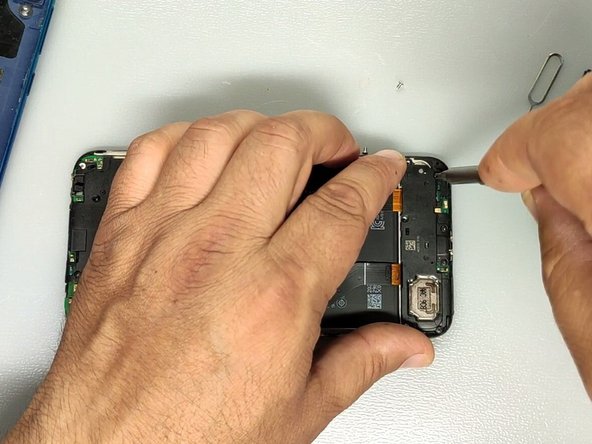

    • Switch off the device.
    • Remove the SIM Tray.
    • Use plastic opening tool to remove the back / battery cover.
    • Gently disconnect the Fingerprint Flex Cable.

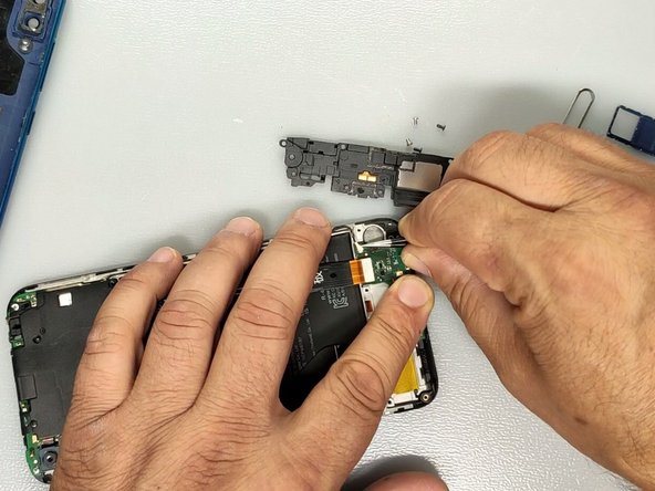

  3. Huawei Y7 2019 Charging Board Replacement: crwdns2935265:03crwdnd2935265:01crwdnd2935265:03crwdne2935265:0 Huawei Y7 2019 Charging Board Replacement: crwdns2935265:03crwdnd2935265:02crwdnd2935265:03crwdne2935265:0 Huawei Y7 2019 Charging Board Replacement: crwdns2935265:03crwdnd2935265:03crwdnd2935265:03crwdne2935265:0
    • Unscrew the 7 Phillips screws.
    • There are 3x white screws and 4x black screws.
    • Use the plastic tool to unstick the daughter board plastic cover.
    • If you find it difficult to remove the plastic cover - use hot air to melt the adhesive.

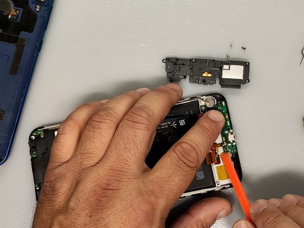

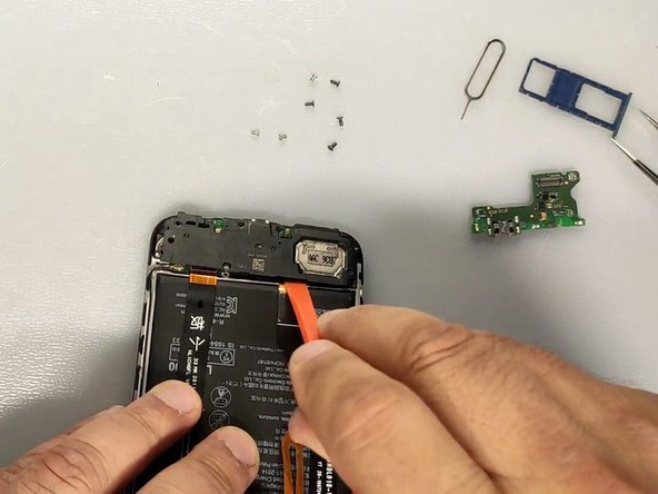

  4. Huawei Y7 2019 Charging Board Replacement: crwdns2935265:04crwdnd2935265:01crwdnd2935265:03crwdne2935265:0 Huawei Y7 2019 Charging Board Replacement: crwdns2935265:04crwdnd2935265:02crwdnd2935265:03crwdne2935265:0 Huawei Y7 2019 Charging Board Replacement: crwdns2935265:04crwdnd2935265:03crwdnd2935265:03crwdne2935265:0
    • Gently disconnect the main flex and the coaxial antenna cable.
    • Use Plastic tool to remove the charging board.

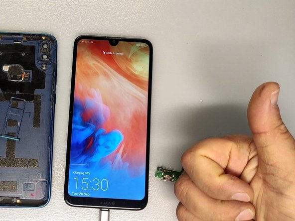

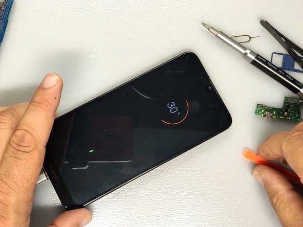

  5. Huawei Y7 2019 Charging Board Replacement: crwdns2935265:05crwdnd2935265:01crwdnd2935265:03crwdne2935265:0 Huawei Y7 2019 Charging Board Replacement: crwdns2935265:05crwdnd2935265:02crwdnd2935265:03crwdne2935265:0 Huawei Y7 2019 Charging Board Replacement: crwdns2935265:05crwdnd2935265:03crwdnd2935265:03crwdne2935265:0
    • Test the charge before assembling the device.
