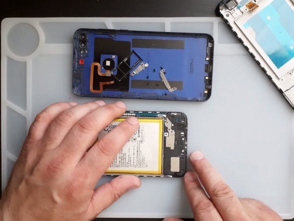

    • Use Plastic tool to separate the back cover
    • With a Phillips screwdriver remove two black screws and the battery flex connector shield
    • Disconnect the battery and the finger print sensor flex cable

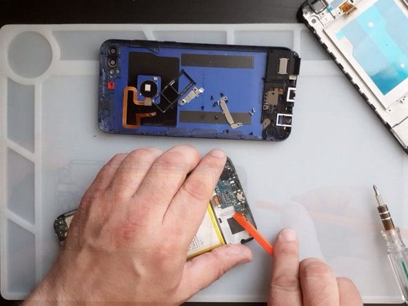

  3. Huawei Y7 2018 (LDN-L21) Display Assembly with Frame Replacement, Logic Board Removal Part 1: crwdns2935265:03crwdnd2935265:01crwdnd2935265:03crwdne2935265:0 Huawei Y7 2018 (LDN-L21) Display Assembly with Frame Replacement, Logic Board Removal Part 1: crwdns2935265:03crwdnd2935265:02crwdnd2935265:03crwdne2935265:0 Huawei Y7 2018 (LDN-L21) Display Assembly with Frame Replacement, Logic Board Removal Part 1: crwdns2935265:03crwdnd2935265:03crwdnd2935265:03crwdne2935265:0
    • Remove all screws from the top of the logic board
    • Remove the shield covering the camera connectors
    • Remove the screws and the plastic cover at the bottom of the device
    • Be careful! Different colored screws have different size
  4. Huawei Y7 2018 (LDN-L21) Display Assembly with Frame Replacement, Logic Board Removal - Part 2: crwdns2935265:04crwdnd2935265:01crwdnd2935265:03crwdne2935265:0 Huawei Y7 2018 (LDN-L21) Display Assembly with Frame Replacement, Logic Board Removal - Part 2: crwdns2935265:04crwdnd2935265:02crwdnd2935265:03crwdne2935265:0 Huawei Y7 2018 (LDN-L21) Display Assembly with Frame Replacement, Logic Board Removal - Part 2: crwdns2935265:04crwdnd2935265:03crwdnd2935265:03crwdne2935265:0
    • Disconnect the Screen Flex cable
    • Remove the logic board
    • Note that at the bottom side of board is attached to the display with double-sided tape

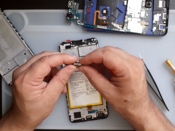

  5. Huawei Y7 2018 (LDN-L21) Display Assembly with Frame Replacement: crwdns2935265:05crwdnd2935265:01crwdnd2935265:03crwdne2935265:0 Huawei Y7 2018 (LDN-L21) Display Assembly with Frame Replacement: crwdns2935265:05crwdnd2935265:02crwdnd2935265:03crwdne2935265:0 Huawei Y7 2018 (LDN-L21) Display Assembly with Frame Replacement: crwdns2935265:05crwdnd2935265:03crwdnd2935265:03crwdne2935265:0
    • Now you have to transfer:
    • Receiver
    • Proximity sensor
    • Volume buttons flex
    • Vibration
    • Battery
