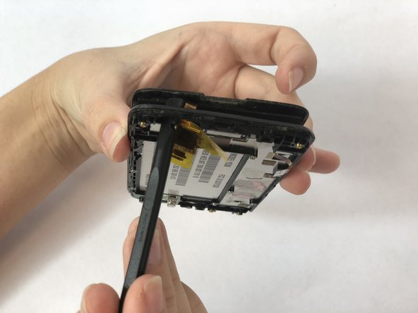

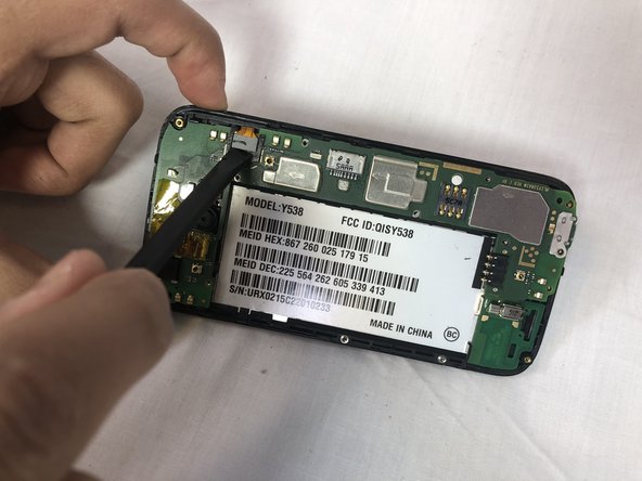

    1. Huawei Union Screen Replacement, Motherboard: crwdns2935265:05crwdnd2935265:01crwdnd2935265:01crwdne2935265:0
      • Remove a single 3mm Phillips #00 screw from the motherboard.
    2. Huawei Union Screen Replacement: crwdns2935265:06crwdnd2935265:01crwdnd2935265:02crwdne2935265:0 Huawei Union Screen Replacement: crwdns2935265:06crwdnd2935265:02crwdnd2935265:02crwdne2935265:0
      • Using the flat end of a spudger to disconnect the motherboard ribbon cable.

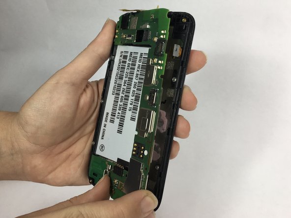

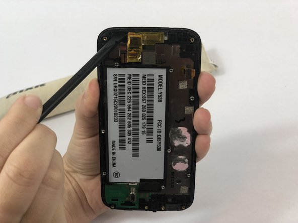

    3. Huawei Union Screen Replacement: crwdns2935265:07crwdnd2935265:01crwdnd2935265:01crwdne2935265:0
      • Firmly hold the second ribbon cable's plastic film cover and pull up to disconnect.
    4. Huawei Union Screen Replacement: crwdns2935265:08crwdnd2935265:01crwdnd2935265:02crwdne2935265:0 Huawei Union Screen Replacement: crwdns2935265:08crwdnd2935265:02crwdnd2935265:02crwdne2935265:0
      • Wedge the flat end of a spudger underneath the motherboard and pry upwards to separate it from the frame.

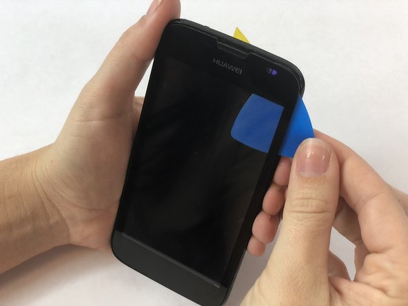

    1. Huawei Union Screen Replacement, Screen: crwdns2935265:09crwdnd2935265:01crwdnd2935265:01crwdne2935265:0
      • Using an iOpener heat source tool, warm the screen of the phone to loosen adhesive of the screen.
    2. Huawei Union Screen Replacement: crwdns2935265:010crwdnd2935265:01crwdnd2935265:02crwdne2935265:0 Huawei Union Screen Replacement: crwdns2935265:010crwdnd2935265:02crwdnd2935265:02crwdne2935265:0

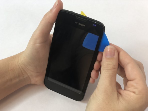

      • Wedge an opening pick underneath the screen and slowly work your way around the screen.
    3. Huawei Union Screen Replacement: crwdns2935265:011crwdnd2935265:01crwdnd2935265:02crwdne2935265:0 Huawei Union Screen Replacement: crwdns2935265:011crwdnd2935265:02crwdnd2935265:02crwdne2935265:0
      • Using multiple Opening Picks, work your way around the edges making sure not to place too much pressure at any one point.
      • With each pass, move the Opening Pick further to complete separation.
    4. Huawei Union Screen Replacement: crwdns2935265:012crwdnd2935265:01crwdnd2935265:03crwdne2935265:0 Huawei Union Screen Replacement: crwdns2935265:012crwdnd2935265:02crwdnd2935265:03crwdne2935265:0 Huawei Union Screen Replacement: crwdns2935265:012crwdnd2935265:03crwdnd2935265:03crwdne2935265:0
      • Once screen is sufficiently separated, holding the sides of the frame firmly, use the Spudger to press through the small access window to the screen at the top let and completely separate the screen from the frame.
      • Do not push too firmly. Screen may break. If screen will not separate, use iOpener heating element again and start over.
      • Do not press too far when separating the screen. There is a small ribbon cable attached to the screen that must be gently drawn through small access window.
    5. Huawei Union Screen Replacement: crwdns2935265:013crwdnd2935265:01crwdnd2935265:01crwdne2935265:0
      • Pull screen away from frame making sure the ribbon cable stays attached.
