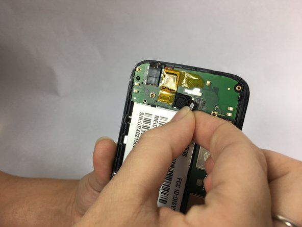

Use this guide if the Huawei Union’s camera will not work properly.
    1. Huawei Union Camera Replacement, Battery: crwdns2935265:01crwdnd2935265:01crwdnd2935265:02crwdne2935265:0 Huawei Union Camera Replacement, Battery: crwdns2935265:01crwdnd2935265:02crwdnd2935265:02crwdne2935265:0
      • Wedge your thumb nail, or the flat end of a spudger, into the bottom left corner and pry off.
    2. Huawei Union Camera Replacement: crwdns2935265:02crwdnd2935265:01crwdnd2935265:02crwdne2935265:0 Huawei Union Camera Replacement: crwdns2935265:02crwdnd2935265:02crwdnd2935265:02crwdne2935265:0
      • Use the flat end of a spudger, or fingernail, to lift up the battery and pull out.
    1. Huawei Union Camera Replacement, Camera Lens Panel: crwdns2935265:03crwdnd2935265:01crwdnd2935265:01crwdne2935265:0
      • Remove the thirteen 3mm Phillips #00 screws from the back panel.
    2. Huawei Union Camera Replacement: crwdns2935265:04crwdnd2935265:01crwdnd2935265:01crwdne2935265:0
      • Use the flat end of a spudger to pry off the back panel.
    1. Huawei Union Camera Replacement, Camera: crwdns2935265:05crwdnd2935265:01crwdnd2935265:02crwdne2935265:0 Huawei Union Camera Replacement, Camera: crwdns2935265:05crwdnd2935265:02crwdnd2935265:02crwdne2935265:0
      • Use the flat end of a spudger to disconnect the camera from the motherboard.
      • Pull the camera out to remove.
