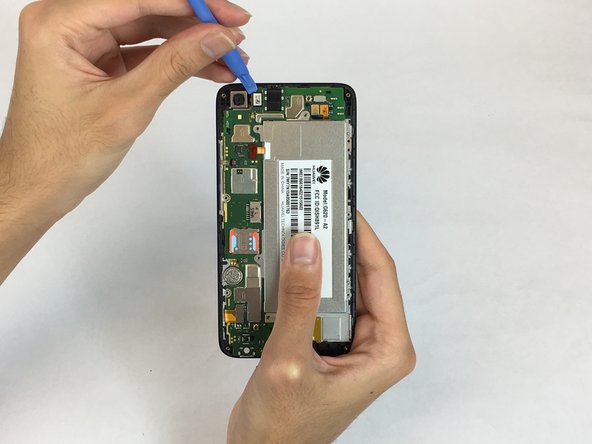

  5. Huawei SnapTo G-620 Motherboard Replacement, Motherboard: crwdns2935265:05crwdnd2935265:01crwdnd2935265:02crwdne2935265:0 Huawei SnapTo G-620 Motherboard Replacement, Motherboard: crwdns2935265:05crwdnd2935265:02crwdnd2935265:02crwdne2935265:0
    • Use a plastic opening tool to remove the pictured flat-top connector.
    • Using the plastic opening tool remove the camera.
