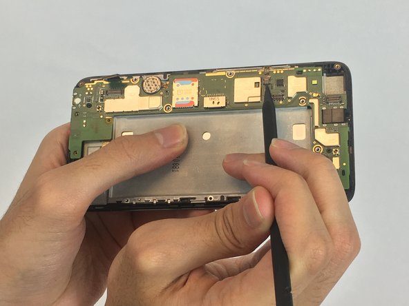

    1. Huawei SnapTo G-620 Microphone Replacement, Battery: crwdns2935265:01crwdnd2935265:01crwdnd2935265:03crwdne2935265:0 Huawei SnapTo G-620 Microphone Replacement, Battery: crwdns2935265:01crwdnd2935265:02crwdnd2935265:03crwdne2935265:0 Huawei SnapTo G-620 Microphone Replacement, Battery: crwdns2935265:01crwdnd2935265:03crwdnd2935265:03crwdne2935265:0
      • Pry open the back cover with your fingernail, using the divot to the lower left hand corner.
      • Remove all fifteen 4mm Phillips J00 screws on the back panel.
      • Using a metal spudger or your fingernail, remove the back panel.

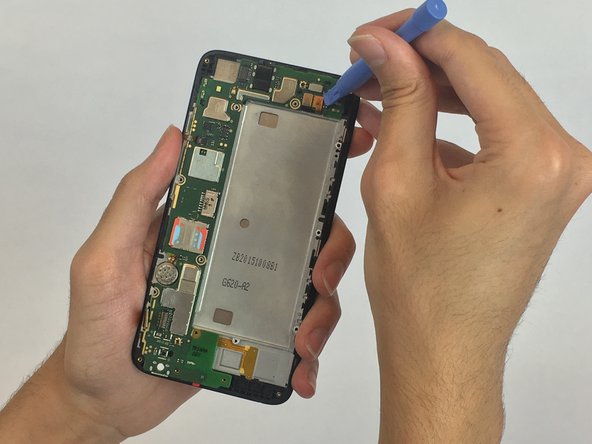

    2. Huawei SnapTo G-620 Microphone Replacement: crwdns2935265:02crwdnd2935265:01crwdnd2935265:01crwdne2935265:0
      • Remove the pictured 4mm Phillips J00 screw.

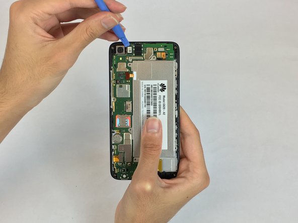

    3. Huawei SnapTo G-620 Microphone Replacement: crwdns2935265:03crwdnd2935265:01crwdnd2935265:02crwdne2935265:0 Huawei SnapTo G-620 Microphone Replacement: crwdns2935265:03crwdnd2935265:02crwdnd2935265:02crwdne2935265:0
      • Use a plastic opening tool to remove the pictured flat-top connector.

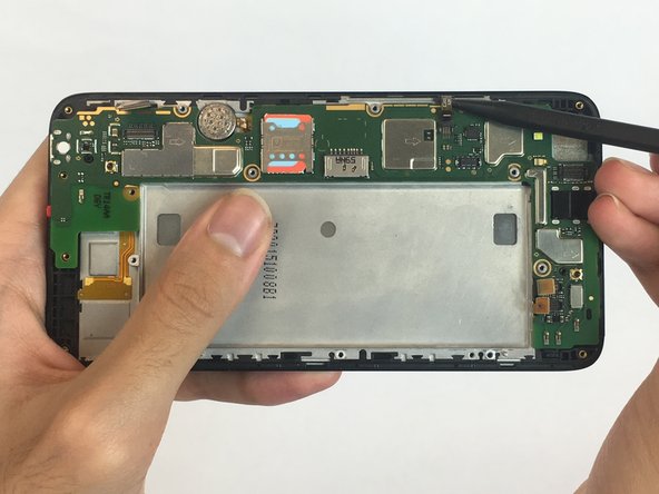

    4. Huawei SnapTo G-620 Microphone Replacement: crwdns2935265:04crwdnd2935265:01crwdnd2935265:01crwdne2935265:0
      • Remove the battery.

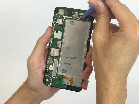

    1. Huawei SnapTo G-620 Microphone Replacement, Microphone: crwdns2935265:05crwdnd2935265:01crwdnd2935265:02crwdne2935265:0 Huawei SnapTo G-620 Microphone Replacement, Microphone: crwdns2935265:05crwdnd2935265:02crwdnd2935265:02crwdne2935265:0
      • Using the plastic opening tool remove the camera.

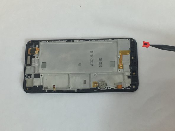

    2. Huawei SnapTo G-620 Microphone Replacement: crwdns2935265:06crwdnd2935265:01crwdnd2935265:03crwdne2935265:0 Huawei SnapTo G-620 Microphone Replacement: crwdns2935265:06crwdnd2935265:02crwdnd2935265:03crwdne2935265:0 Huawei SnapTo G-620 Microphone Replacement: crwdns2935265:06crwdnd2935265:03crwdnd2935265:03crwdne2935265:0
      • Use the plastic opening tool to remove all the remaining flat-top connectors.
    3. Huawei SnapTo G-620 Microphone Replacement: crwdns2935265:07crwdnd2935265:01crwdnd2935265:03crwdne2935265:0 Huawei SnapTo G-620 Microphone Replacement: crwdns2935265:07crwdnd2935265:02crwdnd2935265:03crwdne2935265:0 Huawei SnapTo G-620 Microphone Replacement: crwdns2935265:07crwdnd2935265:03crwdnd2935265:03crwdne2935265:0
      • Using the spudger, pry open the zif connector, and remove the cable.
    4. Huawei SnapTo G-620 Microphone Replacement: crwdns2935265:08crwdnd2935265:01crwdnd2935265:02crwdne2935265:0 Huawei SnapTo G-620 Microphone Replacement: crwdns2935265:08crwdnd2935265:02crwdnd2935265:02crwdne2935265:0
      • Using tweezers or the spudger, remove the microphone.
