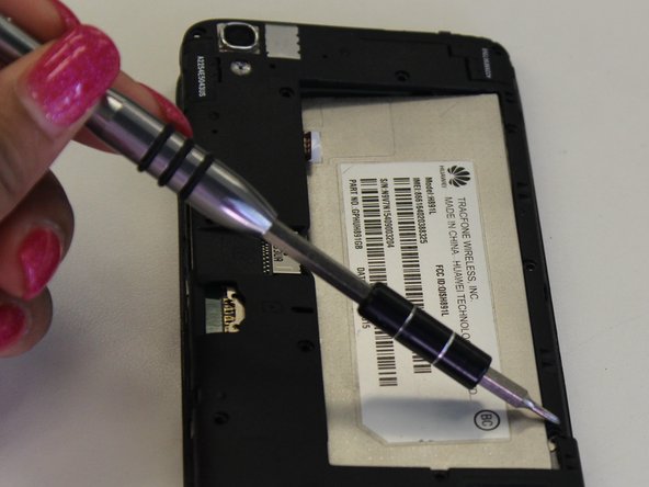

    • Unscrew the fifteen 0.5mm screws with a Phillips #000 screwdriver.

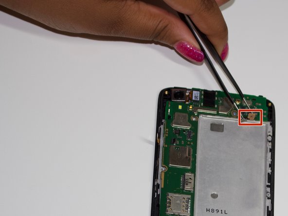

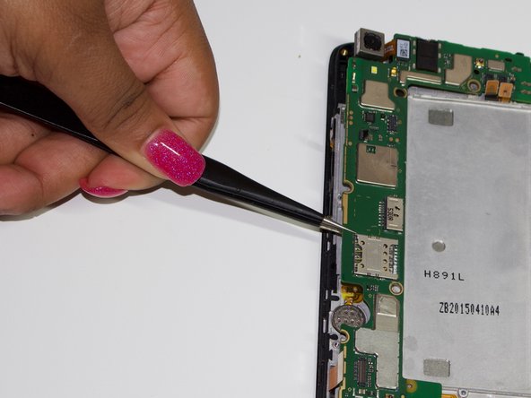

    • Lift up the connectors with tweezers to disconnect them from the motherboard.
    • Then use the tweezer again to take off the motherboard.

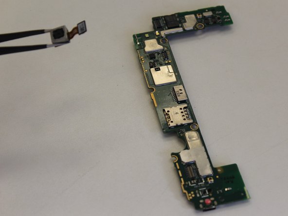

    • Release the connector.
    • Loosen the camera from the motherboard and take it out with the tweezers.
    • Do not touch the camera with your hands, only use tweezers.
