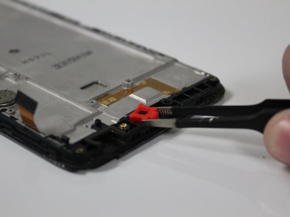

    • Disconnect the connectors from the motherboard and gently remove the motherboard. The motherboard is the green part as shown in the pictures.
  4. Huawei Pronto LTE Microphone Replacement, Microphone: crwdns2935265:04crwdnd2935265:01crwdnd2935265:03crwdne2935265:0 Huawei Pronto LTE Microphone Replacement, Microphone: crwdns2935265:04crwdnd2935265:02crwdnd2935265:03crwdne2935265:0 Huawei Pronto LTE Microphone Replacement, Microphone: crwdns2935265:04crwdnd2935265:03crwdnd2935265:03crwdne2935265:0
