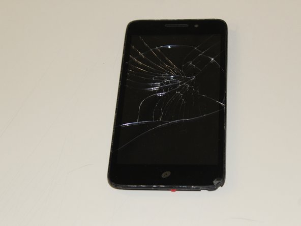

    • Remove the back cover of your Huawei Pronto LTE using an opening tool.
    • Lift the back cover off of the device after the four corners are unlatched.

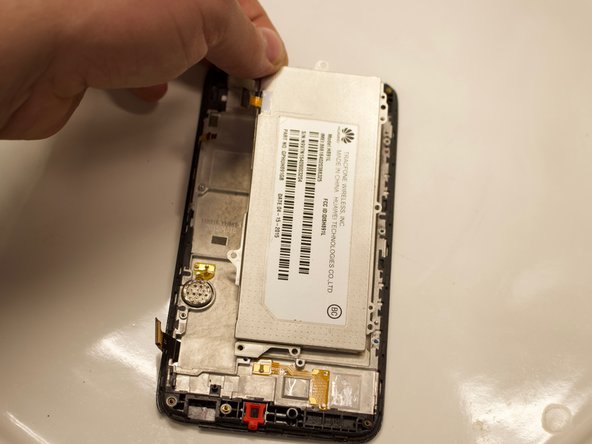

    • Remove the 15 screws on the back of the device using a Phillips #000 screwdriver.
    • Hold the device in place while you are doing this step.
    • Lift the inner cover gently by using a spudger.
