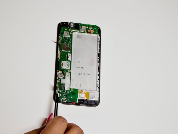

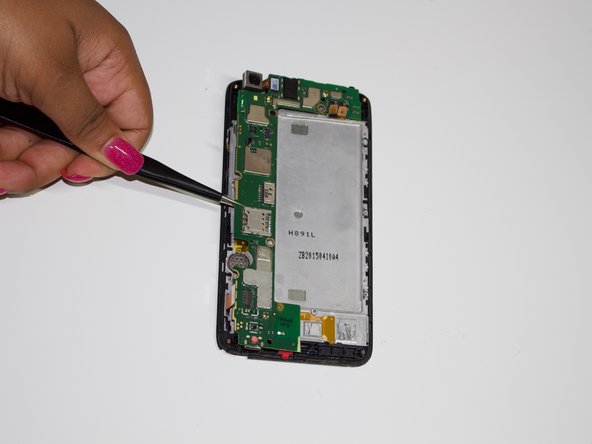

    3. Huawei Pronto LTE Battery Replacement: crwdns2935265:03crwdnd2935265:01crwdnd2935265:03crwdne2935265:0 Huawei Pronto LTE Battery Replacement: crwdns2935265:03crwdnd2935265:02crwdnd2935265:03crwdne2935265:0 Huawei Pronto LTE Battery Replacement: crwdns2935265:03crwdnd2935265:03crwdnd2935265:03crwdne2935265:0
      • Detach the yellow latches along the sides to remove the motherboard.

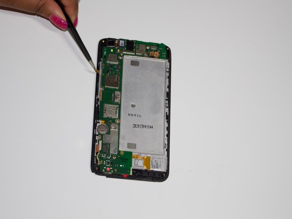

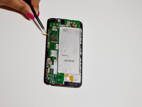

    4. Huawei Pronto LTE Battery Replacement: crwdns2935265:04crwdnd2935265:01crwdnd2935265:03crwdne2935265:0 Huawei Pronto LTE Battery Replacement: crwdns2935265:04crwdnd2935265:02crwdnd2935265:03crwdne2935265:0 Huawei Pronto LTE Battery Replacement: crwdns2935265:04crwdnd2935265:03crwdnd2935265:03crwdne2935265:0
      • Ensure that all latches are detached and that there are no extra screws to avoid damaging the motherboard.
      • Use tweezers to gently remove the motherboard from the device.

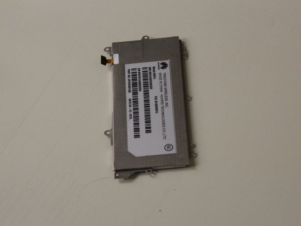

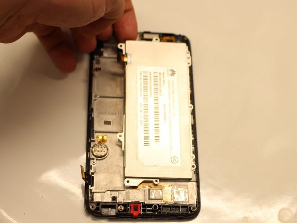

    5. Huawei Pronto LTE Battery Replacement: crwdns2935265:05crwdnd2935265:01crwdnd2935265:03crwdne2935265:0 Huawei Pronto LTE Battery Replacement: crwdns2935265:05crwdnd2935265:02crwdnd2935265:03crwdne2935265:0 Huawei Pronto LTE Battery Replacement: crwdns2935265:05crwdnd2935265:03crwdnd2935265:03crwdne2935265:0
      • The battery should be revealed once the motherboard is removed.
      • Lift the battery from the top left corner.
