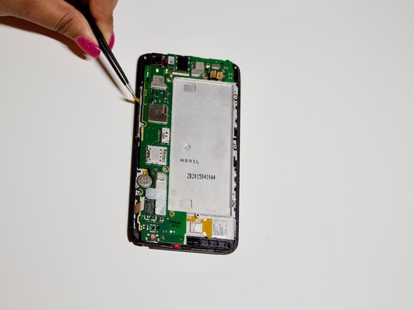

    • Use the opening tool from the iFixit kit to get under the back cover and, gently separate the back from the front.
  2. Huawei Pronto LTE  Motherboard Replacement: crwdns2935265:02crwdnd2935265:01crwdnd2935265:02crwdne2935265:0 Huawei Pronto LTE  Motherboard Replacement: crwdns2935265:02crwdnd2935265:02crwdnd2935265:02crwdne2935265:0
    • Remove the 15 screws on the back of the phone with a Phillips #000 screwdriver. The screws with the red circle around them are the screws you need to remove in order to proceed.

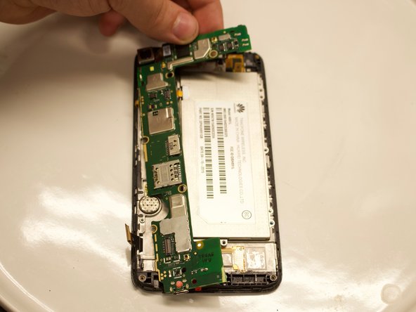

  3. Huawei Pronto LTE  Motherboard Replacement: crwdns2935265:03crwdnd2935265:01crwdnd2935265:03crwdne2935265:0 Huawei Pronto LTE  Motherboard Replacement: crwdns2935265:03crwdnd2935265:02crwdnd2935265:03crwdne2935265:0 Huawei Pronto LTE  Motherboard Replacement: crwdns2935265:03crwdnd2935265:03crwdnd2935265:03crwdne2935265:0
    • Disconnect the connectors from the motherboard and gently remove the motherboard. The motherboard is the green part as shown in the pictures.
