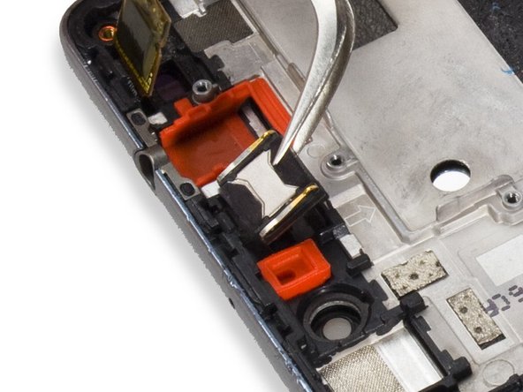

  10. Huawei P8 Lite Earpiece Speaker Replacement, Earpiece Speaker: crwdns2935265:010crwdnd2935265:01crwdnd2935265:02crwdne2935265:0 Huawei P8 Lite Earpiece Speaker Replacement, Earpiece Speaker: crwdns2935265:010crwdnd2935265:02crwdnd2935265:02crwdne2935265:0
    $3.99
    • Using the Tweezers, carefully remove the Earpiece Speaker.
    • Insert the new Earpiece Speaker and follow these steps in reverse order to reassemble the device.
