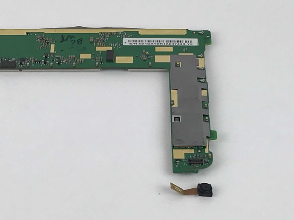

  8. Huawei MediaPad S7-301u Front Camera Replacement, Front Camera: crwdns2935265:08crwdnd2935265:01crwdnd2935265:01crwdne2935265:0
    • Once the battery is removed, remove the front facing camera from the socket located on the top left of the tablet.
  9. Huawei MediaPad S7-301u Front Camera Replacement: crwdns2935265:09crwdnd2935265:01crwdnd2935265:02crwdne2935265:0 Huawei MediaPad S7-301u Front Camera Replacement: crwdns2935265:09crwdnd2935265:02crwdnd2935265:02crwdne2935265:0
    • Gently unclip the camera from the motherboard using your fingers or a pair tweezers.
