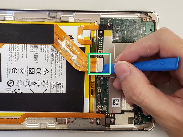

  4. Huawei MediaPad M3 Motherboard Replacement: crwdns2935265:04crwdnd2935265:01crwdnd2935265:03crwdne2935265:0 Huawei MediaPad M3 Motherboard Replacement: crwdns2935265:04crwdnd2935265:02crwdnd2935265:03crwdne2935265:0 Huawei MediaPad M3 Motherboard Replacement: crwdns2935265:04crwdnd2935265:03crwdnd2935265:03crwdne2935265:0
    • Use the plastic opening tool to disconnect the two ribbon cable connectors.

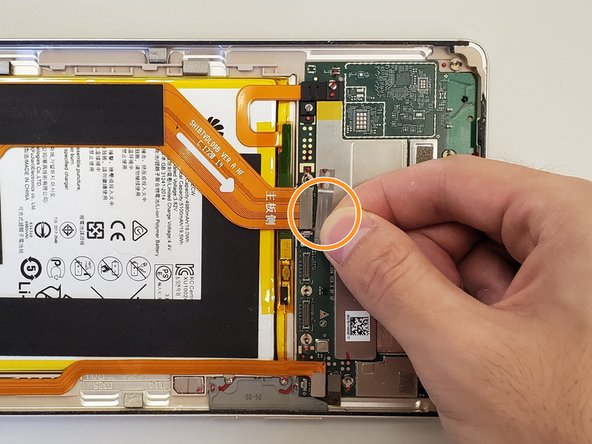

  12. Huawei MediaPad M3 Motherboard Replacement: crwdns2935265:012crwdnd2935265:01crwdnd2935265:02crwdne2935265:0 Huawei MediaPad M3 Motherboard Replacement: crwdns2935265:012crwdnd2935265:02crwdnd2935265:02crwdne2935265:0
    • First, remove the right ribbon cable from the board.
    • Next, remove the left ribbon cable from the board.

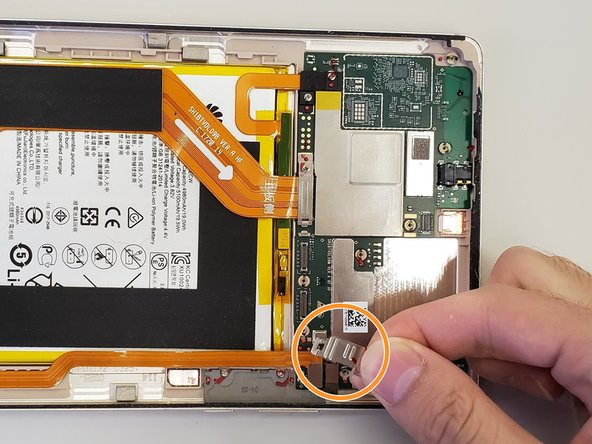

  13. Huawei MediaPad M3 Motherboard Replacement: crwdns2935265:013crwdnd2935265:01crwdnd2935265:03crwdne2935265:0 Huawei MediaPad M3 Motherboard Replacement: crwdns2935265:013crwdnd2935265:02crwdnd2935265:03crwdne2935265:0 Huawei MediaPad M3 Motherboard Replacement: crwdns2935265:013crwdnd2935265:03crwdnd2935265:03crwdne2935265:0
    • Use a Phillips #00 screwdriver to remove the 3mm screw present on top of the silver metal bracket.
    • Remove the silver metal bracket from the board.
    • Remove the yellow ribbon cable using a plastic opening tool.
