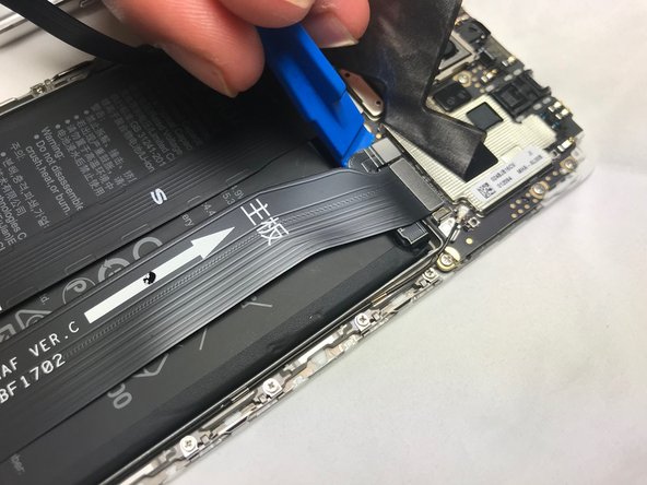

  3. Huawei Mate 9 Rear and Front Camera Replacement: crwdns2935265:03crwdnd2935265:01crwdnd2935265:02crwdne2935265:0 Huawei Mate 9 Rear and Front Camera Replacement: crwdns2935265:03crwdnd2935265:02crwdnd2935265:02crwdne2935265:0
    • To protect the internal cables and components, you will need to carefully disconnect the battery connector. Ensure the 1.3 mm Phillips #000 screws securing the metal plate is removed with a Phillips 000 screwdriver.
    • Remove the metal plate with tweezers.
    • Disconnect the battery connector from the motherboard using the spudger.
  4. Huawei Mate 9 Rear and Front Camera Replacement: crwdns2935265:04crwdnd2935265:01crwdnd2935265:02crwdne2935265:0 Huawei Mate 9 Rear and Front Camera Replacement: crwdns2935265:04crwdnd2935265:02crwdnd2935265:02crwdne2935265:0
    • Using a spudger, disconnect the battery connector.
    • After disconnecting the battery connector, you can now completely remove the back cover.
