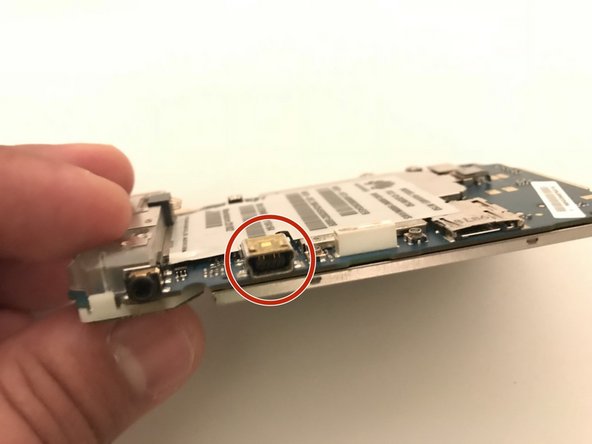

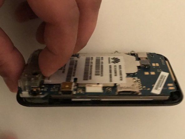

  6. Huawei M750 Charging Port Replacement, Charging Port: crwdns2935265:06crwdnd2935265:01crwdnd2935265:02crwdne2935265:0 Huawei M750 Charging Port Replacement, Charging Port: crwdns2935265:06crwdnd2935265:02crwdnd2935265:02crwdne2935265:0
    • Using the opening tool, start prying out the motherboard from the front panel along the border.
    • When the motherboard seems separated from the front panel, pull it outwards.
  7. Huawei M750 Charging Port Replacement: crwdns2935265:07crwdnd2935265:01crwdnd2935265:02crwdne2935265:0 Huawei M750 Charging Port Replacement: crwdns2935265:07crwdnd2935265:02crwdnd2935265:02crwdne2935265:0
    • The charging port is soldered to the motherboard, use this guide to do the replacement.
