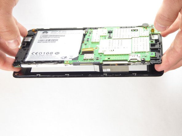

  7. Huawei Ideos S7 Slim Touchscreen Replacement: crwdns2935265:07crwdnd2935265:01crwdnd2935265:03crwdne2935265:0 Huawei Ideos S7 Slim Touchscreen Replacement: crwdns2935265:07crwdnd2935265:02crwdnd2935265:03crwdne2935265:0 Huawei Ideos S7 Slim Touchscreen Replacement: crwdns2935265:07crwdnd2935265:03crwdnd2935265:03crwdne2935265:0
    • Disconnect the five cables connected to the logic board and then carefully lift the logic board out of the casing.
  8. Huawei Ideos S7 Slim Touchscreen Replacement, Touchscreen: crwdns2935265:08crwdnd2935265:01crwdnd2935265:03crwdne2935265:0 Huawei Ideos S7 Slim Touchscreen Replacement, Touchscreen: crwdns2935265:08crwdnd2935265:02crwdnd2935265:03crwdne2935265:0 Huawei Ideos S7 Slim Touchscreen Replacement, Touchscreen: crwdns2935265:08crwdnd2935265:03crwdnd2935265:03crwdne2935265:0
    • Tilt the tablet on its lengthy side, place your thumbs on the side and gently separate the LCD from the touchscreen.
