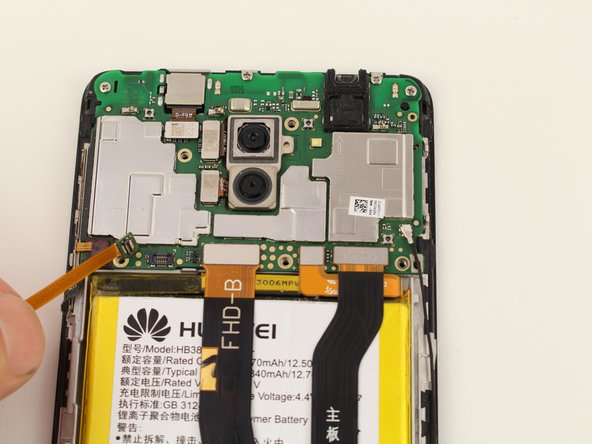

    • Remove the five 4mm Phillips #00 screws using a screwdriver.
  9. Huawei Honor 6x Fingerprint Scanner Replacement: crwdns2935265:09crwdnd2935265:01crwdnd2935265:01crwdne2935265:0
    • Remove the motherboard cover from the device using a spudger or your fingers.
  10. Huawei Honor 6x Fingerprint Scanner Replacement, Fingerprint Scanner: crwdns2935265:010crwdnd2935265:01crwdnd2935265:02crwdne2935265:0 Huawei Honor 6x Fingerprint Scanner Replacement, Fingerprint Scanner: crwdns2935265:010crwdnd2935265:02crwdnd2935265:02crwdne2935265:0
    • Disconnect the fingerprint scanner cable attached to the motherboard using a spudger or your finger.
