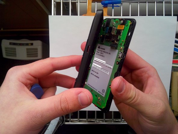

      • Now that the screws are removed, grab a spudger tool or a thick guitar pick. Start at the volume rocker and work your way around the phone by carefully pulling back the frame.

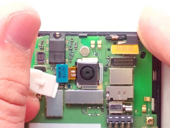

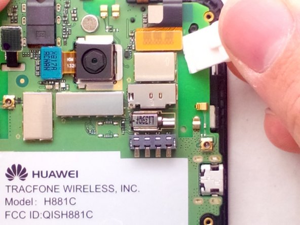

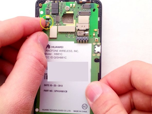

      • We're inside! At this step, there are 3 ribbon cables we need to disconnect to continue. Carefully pull these ribbon connections up.
    5. Huawei H881C Screen Replacement Replacement: crwdns2935265:05crwdnd2935265:01crwdnd2935265:02crwdne2935265:0 Huawei H881C Screen Replacement Replacement: crwdns2935265:05crwdnd2935265:02crwdnd2935265:02crwdne2935265:0
      • Under the screen/digitizer connection, there is one more cable. Carefully disconnect this one was well.

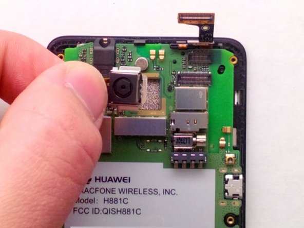

      • Remove the camera by pulling straight up.
    6. Huawei H881C Screen Replacement Replacement: crwdns2935265:06crwdnd2935265:01crwdnd2935265:03crwdne2935265:0 Huawei H881C Screen Replacement Replacement: crwdns2935265:06crwdnd2935265:02crwdnd2935265:03crwdne2935265:0 Huawei H881C Screen Replacement Replacement: crwdns2935265:06crwdnd2935265:03crwdnd2935265:03crwdne2935265:0

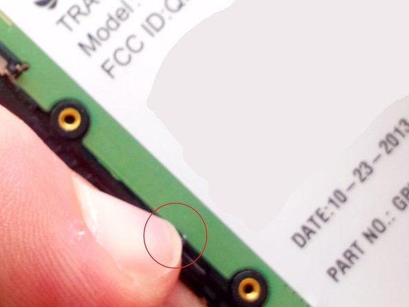

      • Don't mind the ugly "circles". What is circled is the clips you need to pull back to remove the motherboard from the frame.
      • Your fingernail will work perfect for this.
      • Let's remove the motherboard. With your right hand, slowly pull back the motherboard. With you left hand, guide the ribbon cable through the hole to avoid damaging it.

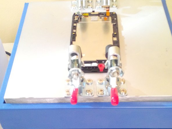

      • Now that the motherboard is out, this is the screen/digitizer/LCD assembly. From here, we need to only remove the digitizer.

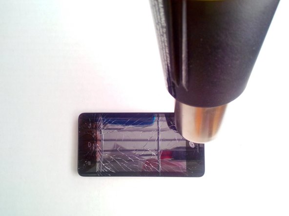

      • We recommend using a heat gun or a hot plate if you have one. If you don't have either, use a blow dryer!

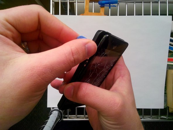

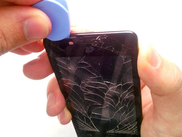

      • After its hot enough, use a thick guitar pick to peel back the broken screen from the frame. Be careful, it may be hot and glass could get everywhere.
      • Once you've removed the old screen/digitizer, apply new adhesive on the frame and put the new part on. Make sure that you get the old adhesive peeled off. We recommend heating the adhesive before applying the new screen for better bonding.
