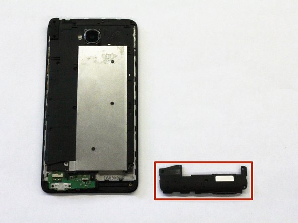

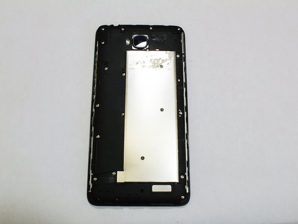

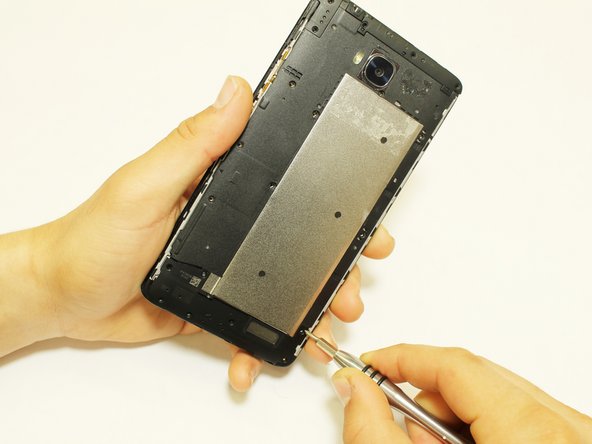

  4. Huawei Ascend XT Speaker Replacement: crwdns2935265:04crwdnd2935265:01crwdnd2935265:02crwdne2935265:0 Huawei Ascend XT Speaker Replacement: crwdns2935265:04crwdnd2935265:02crwdnd2935265:02crwdne2935265:0
    • Remove the seven screws using a Phillips #00 screwdriver.
  5. Huawei Ascend XT Speaker Replacement: crwdns2935265:05crwdnd2935265:01crwdnd2935265:02crwdne2935265:0 Huawei Ascend XT Speaker Replacement: crwdns2935265:05crwdnd2935265:02crwdnd2935265:02crwdne2935265:0
    • Use the spudger to carefully pull off the speaker assembly.
    • Once off you will replace it with your new speaker assembly.
