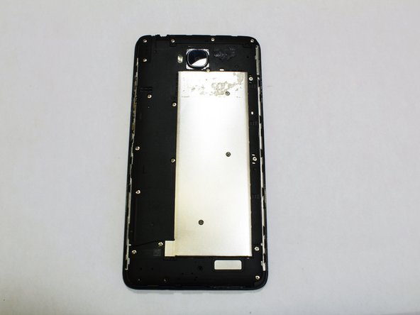

  3. Huawei Ascend XT Screen Replacement: crwdns2935265:03crwdnd2935265:01crwdnd2935265:02crwdne2935265:0 Huawei Ascend XT Screen Replacement: crwdns2935265:03crwdnd2935265:02crwdnd2935265:02crwdne2935265:0
    • Slide the flat end of the spudger along the edge of the device, prying off the back cover.
    • Carefully remove the back cover. This may be difficult due to glue on the inside.

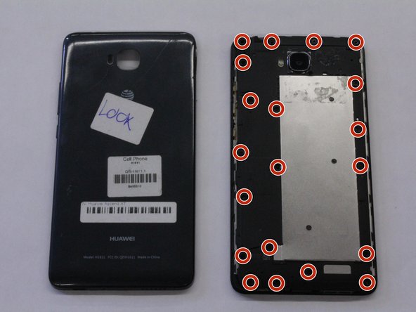

  4. Huawei Ascend XT Screen Replacement: crwdns2935265:04crwdnd2935265:01crwdnd2935265:02crwdne2935265:0 Huawei Ascend XT Screen Replacement: crwdns2935265:04crwdnd2935265:02crwdnd2935265:02crwdne2935265:0
    • Use the Phillips head bit to remove 20 screws.

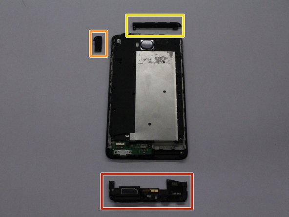

  5. Huawei Ascend XT Screen Replacement: crwdns2935265:05crwdnd2935265:01crwdnd2935265:03crwdne2935265:0 Huawei Ascend XT Screen Replacement: crwdns2935265:05crwdnd2935265:02crwdnd2935265:03crwdne2935265:0 Huawei Ascend XT Screen Replacement: crwdns2935265:05crwdnd2935265:03crwdnd2935265:03crwdne2935265:0

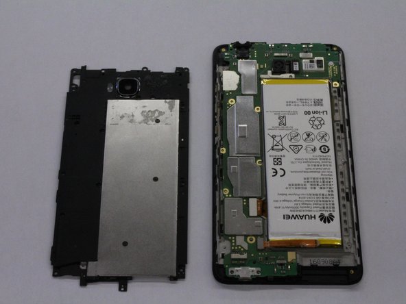

    • Carefully pull off the speaker assembly.
    • Carefully pull off the antenna assembly.
    • Carefully pull off the top left tab.
    • Carefully remove the back plate assembly.

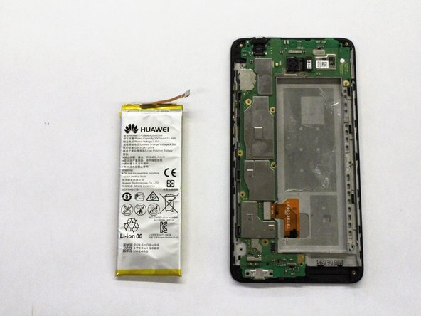

  6. Huawei Ascend XT Screen Replacement: crwdns2935265:06crwdnd2935265:01crwdnd2935265:01crwdne2935265:0
    • Carefully disconnect battery ribbon wire from lower left corner of circuit board.
  7. Huawei Ascend XT Screen Replacement: crwdns2935265:07crwdnd2935265:01crwdnd2935265:02crwdne2935265:0 Huawei Ascend XT Screen Replacement: crwdns2935265:07crwdnd2935265:02crwdnd2935265:02crwdne2935265:0
    • Use the spudger to pry lithium battery away from battery compartment.
    • Insert new battery and connect.

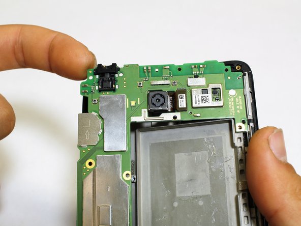

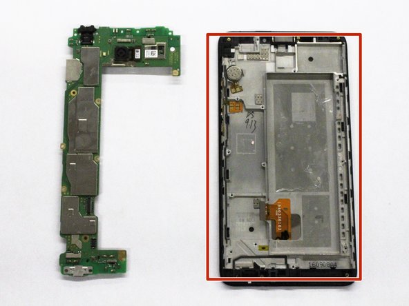

  8. Huawei Ascend XT Screen Replacement: crwdns2935265:08crwdnd2935265:01crwdnd2935265:03crwdne2935265:0 Huawei Ascend XT Screen Replacement: crwdns2935265:08crwdnd2935265:02crwdnd2935265:03crwdne2935265:0 Huawei Ascend XT Screen Replacement: crwdns2935265:08crwdnd2935265:03crwdnd2935265:03crwdne2935265:0
    • Carefully disconnect screen assembly ribbon wire from mother board.
    • Carefully remove the mother board from the screen assembly.
    • Replace screen assembly.
