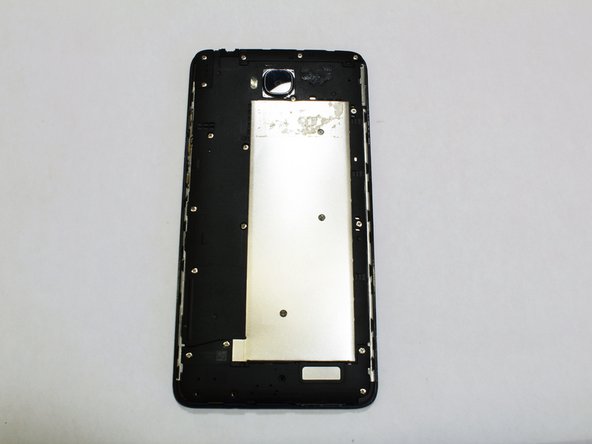

  4. Huawei Ascend XT Battery Replacement: crwdns2935265:04crwdnd2935265:01crwdnd2935265:02crwdne2935265:0 Huawei Ascend XT Battery Replacement: crwdns2935265:04crwdnd2935265:02crwdnd2935265:02crwdne2935265:0
    • Use a Phillips screwdriver to remove 20 screws around the perimeter of the phone.

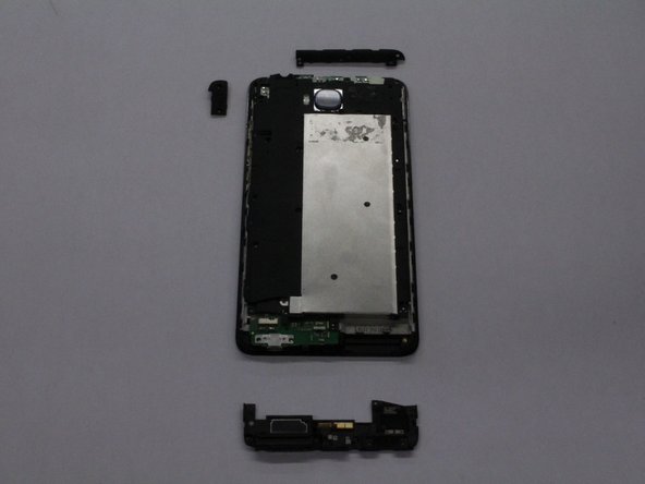

  5. Huawei Ascend XT Battery Replacement: crwdns2935265:05crwdnd2935265:01crwdnd2935265:03crwdne2935265:0 Huawei Ascend XT Battery Replacement: crwdns2935265:05crwdnd2935265:02crwdnd2935265:03crwdne2935265:0 Huawei Ascend XT Battery Replacement: crwdns2935265:05crwdnd2935265:03crwdnd2935265:03crwdne2935265:0
    • First, carefully remove the speaker assembly at the bottom of the phone.
    • Use a spudger to pry up the antenna assembly located along the top right-hand side of the phone.
    • Use a spudger to pull off the top-left tab.
    • Finally, carefully remove the entire back plate assembly from the motherboard.
