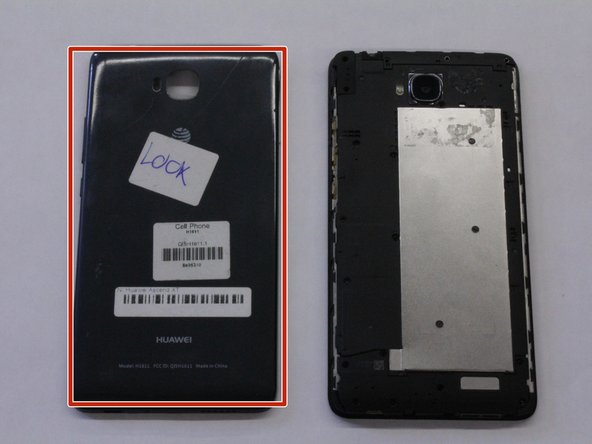

    • Use the 0.8 Sim driver bit to remove the SIM tray by inserting it into the hole on the side of the device.
    • Once the hole is pressed in firm, the SIM tray will pop out. This allows you to grab it and extract it from the device.
  2. Huawei Ascend XT Back Cover Replacement: crwdns2935265:02crwdnd2935265:01crwdnd2935265:02crwdne2935265:0 Huawei Ascend XT Back Cover Replacement: crwdns2935265:02crwdnd2935265:02crwdnd2935265:02crwdne2935265:0
    • Make a thumbs-up and use it to grip the plastic opening tool with the flat end pointing in the direction of your thumb.
    • Place the flat end of the opening tool slightly inside the charging port and place your thumb on the back of the phone.
    • Press into the phone with your thumb while pulling the opening tool back with your fist to begin prying the back off.

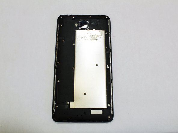

  3. Huawei Ascend XT Back Cover Replacement: crwdns2935265:03crwdnd2935265:01crwdnd2935265:03crwdne2935265:0 Huawei Ascend XT Back Cover Replacement: crwdns2935265:03crwdnd2935265:02crwdnd2935265:03crwdne2935265:0 Huawei Ascend XT Back Cover Replacement: crwdns2935265:03crwdnd2935265:03crwdnd2935265:03crwdne2935265:0
    • Slide the flat end of the spudger along the edge of the device, prying off the back cover.
    • Carefully remove the back cover. This may be difficult due to glue on the inside.
    • Replace the back cover with a new one and reassemble the device.
