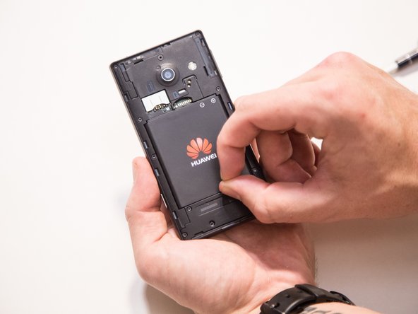

  4. Huawei Ascend W1 Speaker Replacement, Removing the battery.: crwdns2935265:04crwdnd2935265:01crwdnd2935265:03crwdne2935265:0 Huawei Ascend W1 Speaker Replacement, Removing the battery.: crwdns2935265:04crwdnd2935265:02crwdnd2935265:03crwdne2935265:0 Huawei Ascend W1 Speaker Replacement, Removing the battery.: crwdns2935265:04crwdnd2935265:03crwdnd2935265:03crwdne2935265:0
    • Find the indented notch at the base of the battery.
    • Lift the battery out of the phone with your fingers by pressing forward and lifting upward.

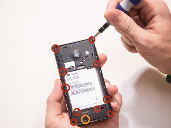

  5. Huawei Ascend W1 Speaker Replacement, Remove all the screws: crwdns2935265:05crwdnd2935265:01crwdnd2935265:02crwdne2935265:0 Huawei Ascend W1 Speaker Replacement, Remove all the screws: crwdns2935265:05crwdnd2935265:02crwdnd2935265:02crwdne2935265:0
    • After removing the battery, you will need to remove the screws holding the phone's middle cover.
    • There are eleven screws that hold the plate to the rest of the phone.
    • The screw that is marked by the orange circle is covered by a white dot. It is used as a tampering deterrent.

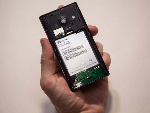

  6. Huawei Ascend W1 Speaker Replacement, Removing the lower circuit plate: crwdns2935265:06crwdnd2935265:01crwdnd2935265:02crwdne2935265:0 Huawei Ascend W1 Speaker Replacement, Removing the lower circuit plate: crwdns2935265:06crwdnd2935265:02crwdnd2935265:02crwdne2935265:0
    • After all the screws are removed from the back circuit, use your fingers to remove the lower section of the middle cover.
    • Grab the top of the lower middle cover and pull it outward towards you, exposing the circuit board underneath.

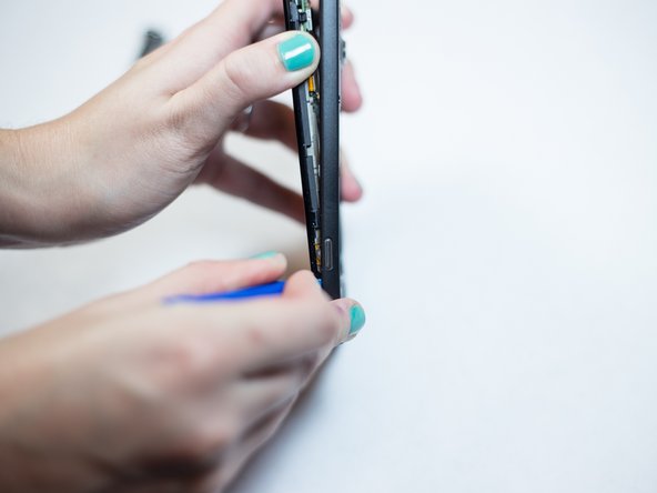

  7. Huawei Ascend W1 Speaker Replacement, Removing the rest of the middle cover.: crwdns2935265:07crwdnd2935265:01crwdnd2935265:02crwdne2935265:0 Huawei Ascend W1 Speaker Replacement, Removing the rest of the middle cover.: crwdns2935265:07crwdnd2935265:02crwdnd2935265:02crwdne2935265:0
    • Begin working your way around the sides of the middle cover, unsnapping it gently.
    • Be gentle as you pry the middle cover off. The parts may break if you are too forceful.

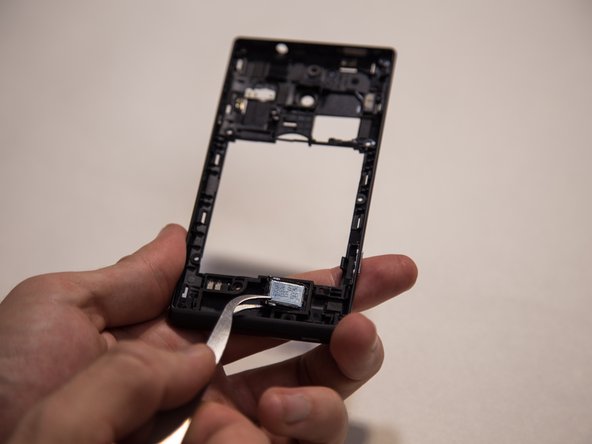

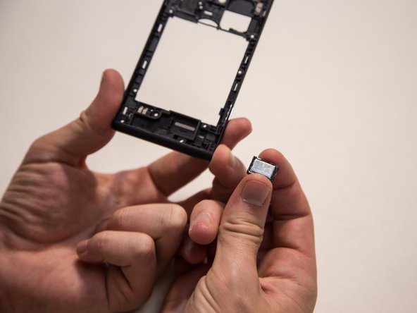

  8. Huawei Ascend W1 Speaker Replacement, Removing the speaker: crwdns2935265:08crwdnd2935265:01crwdnd2935265:03crwdne2935265:0 Huawei Ascend W1 Speaker Replacement, Removing the speaker: crwdns2935265:08crwdnd2935265:02crwdnd2935265:03crwdne2935265:0 Huawei Ascend W1 Speaker Replacement, Removing the speaker: crwdns2935265:08crwdnd2935265:03crwdnd2935265:03crwdne2935265:0
    • The speaker is attached to the inside of the back cover and visible once the middle cover is removed.
    • Using small pliers, gently remove the speaker.
    • The speaker may be difficult to remove due to the adhesive that keeps it in place.
