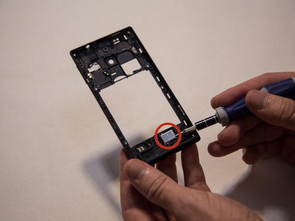

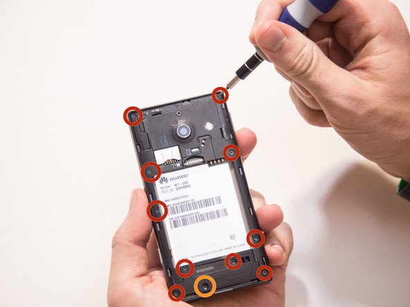

    • After removing the battery, remove the screws using a T6 screwdriver.
    • There are eleven screws that hold the middle cover to the rest of the phone.
    • The screw that is marked by the orange circle is covered by a white dot.

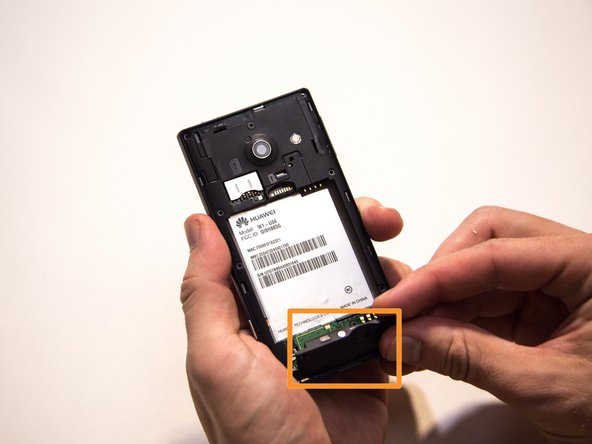

  6. Huawei Ascend W1 Motherboard Replacement, Removing lower section of the middle cover.: crwdns2935265:06crwdnd2935265:01crwdnd2935265:03crwdne2935265:0 Huawei Ascend W1 Motherboard Replacement, Removing lower section of the middle cover.: crwdns2935265:06crwdnd2935265:02crwdnd2935265:03crwdne2935265:0 Huawei Ascend W1 Motherboard Replacement, Removing lower section of the middle cover.: crwdns2935265:06crwdnd2935265:03crwdnd2935265:03crwdne2935265:0
    • After all the screws are removed, use your fingers to remove the lower section of the middle cover.
    • Pull the lower section of the middle cover outward towards you, exposing the circuit board underneath.

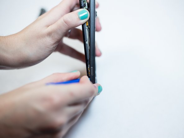

  7. Huawei Ascend W1 Motherboard Replacement, Removing the rest of the middle cover.: crwdns2935265:07crwdnd2935265:01crwdnd2935265:03crwdne2935265:0 Huawei Ascend W1 Motherboard Replacement, Removing the rest of the middle cover.: crwdns2935265:07crwdnd2935265:02crwdnd2935265:03crwdne2935265:0 Huawei Ascend W1 Motherboard Replacement, Removing the rest of the middle cover.: crwdns2935265:07crwdnd2935265:03crwdnd2935265:03crwdne2935265:0
    • Begin working your way around the sides of the cover plate, unsnapping it gently.
    • The middle cover is a thin piece of plastic with the external speaker inside of it.
    • Be gentle as you remove circuit cover. The parts might break if you are too forceful.

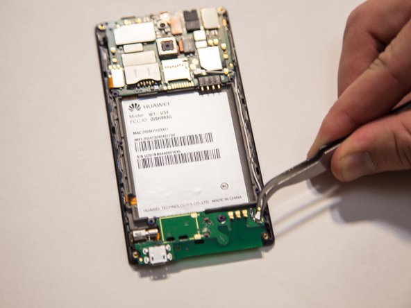

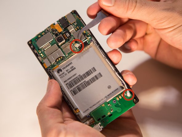

  8. Huawei Ascend W1 Motherboard Replacement, Locating the antenna.: crwdns2935265:08crwdnd2935265:01crwdnd2935265:02crwdne2935265:0 Huawei Ascend W1 Motherboard Replacement, Locating the antenna.: crwdns2935265:08crwdnd2935265:02crwdnd2935265:02crwdne2935265:0
    • The middle covers are removed.
    • The antenna is a thin white wire that connects to the circuit board in two locations.
  9. Huawei Ascend W1 Motherboard Replacement, Removing the antenna: crwdns2935265:09crwdnd2935265:01crwdnd2935265:02crwdne2935265:0 Huawei Ascend W1 Motherboard Replacement, Removing the antenna: crwdns2935265:09crwdnd2935265:02crwdnd2935265:02crwdne2935265:0
    • Lift gently at each connector of the white wire to disconnect the antenna from the port.

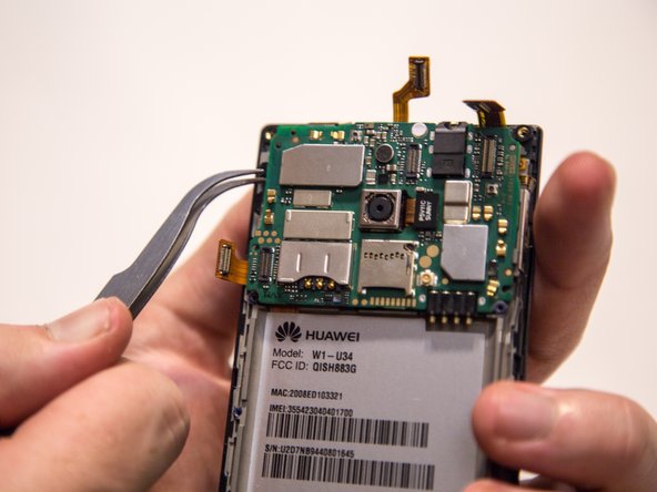

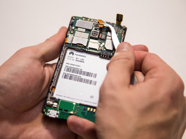

  10. Huawei Ascend W1 Motherboard Replacement, Motherboard: crwdns2935265:010crwdnd2935265:01crwdnd2935265:03crwdne2935265:0 Huawei Ascend W1 Motherboard Replacement, Motherboard: crwdns2935265:010crwdnd2935265:02crwdnd2935265:03crwdne2935265:0 Huawei Ascend W1 Motherboard Replacement, Motherboard: crwdns2935265:010crwdnd2935265:03crwdnd2935265:03crwdne2935265:0
    • Use a plastic spudger or your fingers to gently pry up the four flex cables from the main board.

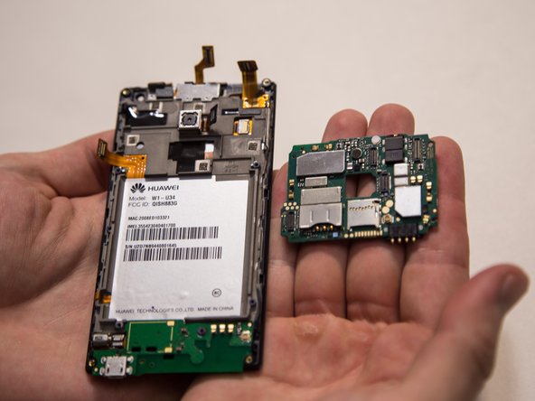

  11. Huawei Ascend W1 Motherboard Replacement: crwdns2935265:011crwdnd2935265:01crwdnd2935265:02crwdne2935265:0 Huawei Ascend W1 Motherboard Replacement: crwdns2935265:011crwdnd2935265:02crwdnd2935265:02crwdne2935265:0
    • With the back of the phone facing you, there will be a small black clip on the left side holding the main board in place.
    • Gently pry up near the small black clip with your fingers or a plastic spudger to detach the main board.
