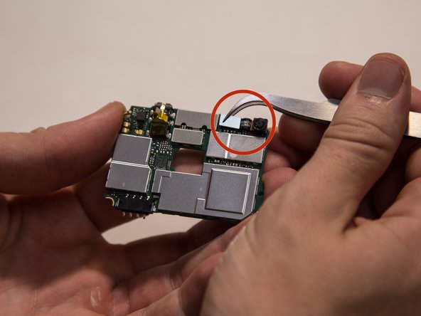

  12. Huawei Ascend W1 Front Facing Camera Replacement, Locate the front camera: crwdns2935265:012crwdnd2935265:01crwdnd2935265:02crwdne2935265:0 Huawei Ascend W1 Front Facing Camera Replacement, Locate the front camera: crwdns2935265:012crwdnd2935265:02crwdnd2935265:02crwdne2935265:0
    • With the main board facing away from you, the front camera is on the top right corner.
    • There is a silver connector and a black flex cable attached to the front camera.
  13. Huawei Ascend W1 Front Facing Camera Replacement, Remove the front camera: crwdns2935265:013crwdnd2935265:01crwdnd2935265:01crwdne2935265:0
    • Using the small pliers, disconnect the front camera's flex cable from the main board.
  14. Huawei Ascend W1 Front Facing Camera Replacement, Removing the front camera.: crwdns2935265:014crwdnd2935265:01crwdnd2935265:01crwdne2935265:0
    • Once the flex cable is disconnected, completely remove the front camera off the main board.
