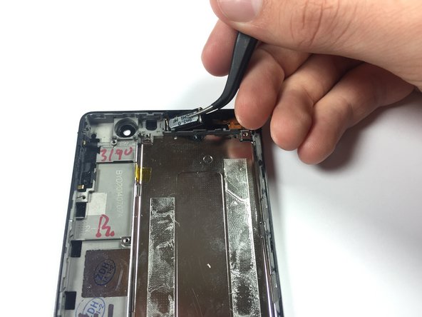

  18. Huawei Ascend P6-U06 Screen/LCD Display Replacement, Earpiece Speaker: crwdns2935265:018crwdnd2935265:01crwdnd2935265:02crwdne2935265:0 Huawei Ascend P6-U06 Screen/LCD Display Replacement, Earpiece Speaker: crwdns2935265:018crwdnd2935265:02crwdnd2935265:02crwdne2935265:0
    • Use the pointy end of a spudger to wedge underneath the earpiece speaker, and gently pry upward.
    • Use tweezers to remove the earpiece speaker from the frame.
    • There is adhesive holding down the earpiece speaker to the frame. If the earpiece speaker is not breaking free, gently wiggle it until it comes loose.

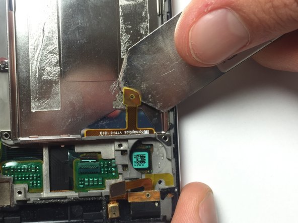

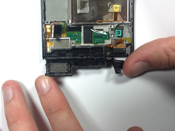

  19. Huawei Ascend P6-U06 Screen/LCD Display Replacement, Screen/LCD Display: crwdns2935265:019crwdnd2935265:01crwdnd2935265:02crwdne2935265:0 Huawei Ascend P6-U06 Screen/LCD Display Replacement, Screen/LCD Display: crwdns2935265:019crwdnd2935265:02crwdnd2935265:02crwdne2935265:0
    • Use the pointy end of a spudger to peel back and fold down the black plastic cover near the bottom left of the phone.
  20. Huawei Ascend P6-U06 Screen/LCD Display Replacement: crwdns2935265:020crwdnd2935265:01crwdnd2935265:02crwdne2935265:0 Huawei Ascend P6-U06 Screen/LCD Display Replacement: crwdns2935265:020crwdnd2935265:02crwdnd2935265:02crwdne2935265:0
    • Use an iSesamo tool to separate the gold wire from the silver metal plate.
    • This piece will not come off completely, but it must be separated in order to remove the display.
    • Be careful not to slice or damage the wire. The wire is attached to the panel with a layer of adhesive, so it will take some effort to remove.

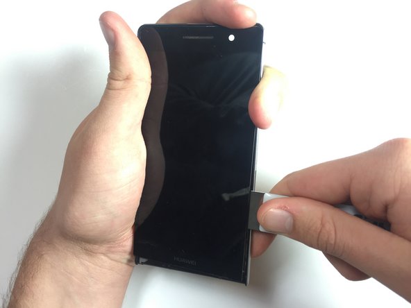

  22. Huawei Ascend P6-U06 Screen/LCD Display Replacement: crwdns2935265:022crwdnd2935265:01crwdnd2935265:02crwdne2935265:0 Huawei Ascend P6-U06 Screen/LCD Display Replacement: crwdns2935265:022crwdnd2935265:02crwdnd2935265:02crwdne2935265:0
    • Use the iSeasmo tool to wedge between the screen and the plastic near the bottom right corner of the phone. You must wedge the iSeasmo underneath the white plastic part of the screen, and not just the glass.
    • Run your iSeasmo tool slowly to the left and right to begin separating the display.
    • Run your iSeasmo tool along the right and left edges of the display.
    • Adhesive will be found throughout this process, so you must be patient with the separation. Check the back of the phone once in awhile to make sure you are not cutting any wires.

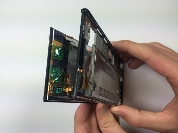

  23. Huawei Ascend P6-U06 Screen/LCD Display Replacement: crwdns2935265:023crwdnd2935265:01crwdnd2935265:02crwdne2935265:0 Huawei Ascend P6-U06 Screen/LCD Display Replacement: crwdns2935265:023crwdnd2935265:02crwdnd2935265:02crwdne2935265:0
    • Once the display is loose enough, gently begin separating it from the bottom of the phone. Work your way up until it is completely removed.
    • Some wires will need to be fed through holes in the plastic before the display can be fully removed.
    • Avoid forcing the screen from the plastic. This can damage the screen along with the internal wiring. Take this step very slowly, and go back to remove any extra adhesive if necessary.
